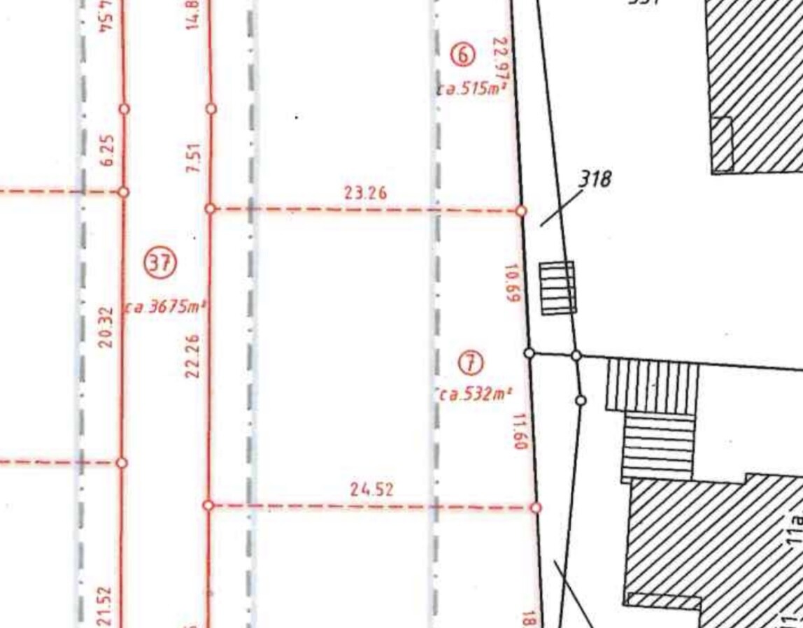

You know: you can switch the whole floor/house around… But 1. we don’t know your requirements, 2. we don’t know your plot. We don’t know why the design is the way it is. Our advice can only be misleading!What exactly do you mean by requirements, like how many rooms, or things like the south/west side should provide plenty of light?
I think we kept it pretty minimal: we said how many rooms we need, approximate sizes (after visiting show homes), living/dining/kitchen area in an L-shape, guest toilet without shower, office, 2 children’s bedrooms, 1 master bedroom without a large walk-in closet, 1 main bathroom with double sink, bathtub, shower 150x100cm (59x39 inches), no basement, and an unheated attic.
Hallway shouldn’t take up too much space and staircase should be as optimal as possible. Those were our internal requirements.
We would like plenty of light from the south and west, with floor-to-ceiling windows there because the garden is on that side.
I attached the plot from the subdivision plan: the street is on the west side, a traffic-calmed dead-end street; to the east there are existing buildings with 1.5-story single-family houses; north and south are new building plots like ours.
