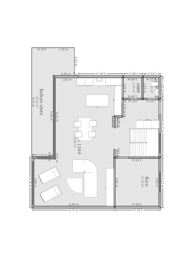

Dipl-WiING12 Dec 2013 16:49Hello, it took a bit longer than expected... Ok, I have now discussed the design with various experts such as architects. Even though I’m not 100% satisfied yet, or maybe because of that, I’d like to present it here again for discussion. If you point out any issues, please also suggest possible improvements, as that’s the only way it will help me. I am now considering whether to build a basement under the carport in front of the house or to have a prefabricated basement next to the house only…
Regards,
Pit
Regards,
Pit

Doc.Schnaggls13 Dec 2013 09:38Hello,
I am missing the windows in the basement level.
I also find the relatively narrow passage between the front door/stairs and the kitchen wall to be problematic.
The placement of the kitchen island is also difficult – the passage there seems to be only about 50cm (20 inches) wide...
Regards,
Dirk
