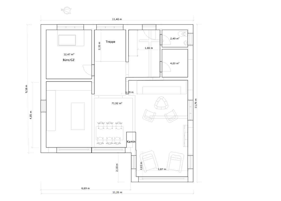

Hello, as I mentioned before on the forum, due to the sloped site (and the fact that we need a basement anyway) we will probably omit the upper floor.
Now we plan to develop the basement as a fully functional living area with a large glass front. We spent several hours working on the floor plan and wanted to ask an architect for their opinion, but unfortunately all three architects I contacted are currently too busy with other projects.
So I’m asking for your help.
It was important to us that you can go directly from the ground floor down the stairs to the terrace, and otherwise to have as few square meters wasted on hallways as possible. The ground floor (above) is mostly open except for a small guest toilet and an office.
The staircase is separated by a large built-in wall cabinet. The terrace above partly extends the carport and partly will have a wooden structure to bring the terrace size to about 12–14m² (130–150 sq ft). The house is oriented southwest.
Thank you very much for any advice!

Wanderdüne21 Dec 2013 14:18Just between us: Why don’t you find an independent architect who can create a design based on your wishes, the surroundings, and the legal requirements? And please, don’t influence the design with your floor plan.
I’m sure you won’t regret it.
When I read terms like sloped site, building window width 15m (50 feet), etc., I imagine an exciting building that integrates the residents into the landscape and offers a great view. In your design, there is a corner sofa in front of the window. If you’re lucky, you can see the TV; the others look at a wall corner or into the building. But for that, you don’t need a sloped site...

Dipl-WiING21 Dec 2013 16:17Wanderdüne schrieb:
Just between us: Why don’t you hire an independent architect who, based on your wishes, the surroundings, and the legal requirements, creates a design for you? And please, without influencing them with your floor plan.
When I read terms like sloped site, building plot width 15m (50 feet), etc., I imagine an exciting building that integrates the residents into the landscape and offers a fantastic view.
In your design, there’s a corner sofa in front of the window; if you’re lucky, you see the TV, otherwise, you’re looking at a corner wall or into the building. But for that, you don’t need a sloped site...
WDFirst of all, thanks for the feedback!
@WD, of course I fully agree with you, and that’s our plan as well. Unfortunately, it will still take almost two weeks until we have an appointment with an architect who will also visit the site in person.
A quick note regarding your comments: I don’t understand why the sofa is placed that way either. The bay window is actually meant to be a kind of sunroom with two lounge chairs... The bay is located there because around 10m (33 feet) to the left, the neighbor’s house with a balcony at the same level stands. This “bay window” is intended to act as a visual shield for our balcony. Having a good view is very important to me, which is why we plan to install large floor-to-ceiling windows both upstairs and downstairs. Just a little remark—overall, I’m currently slowly getting clearer on what I actually want... and I find this discussion very helpful.
Regards, Pit

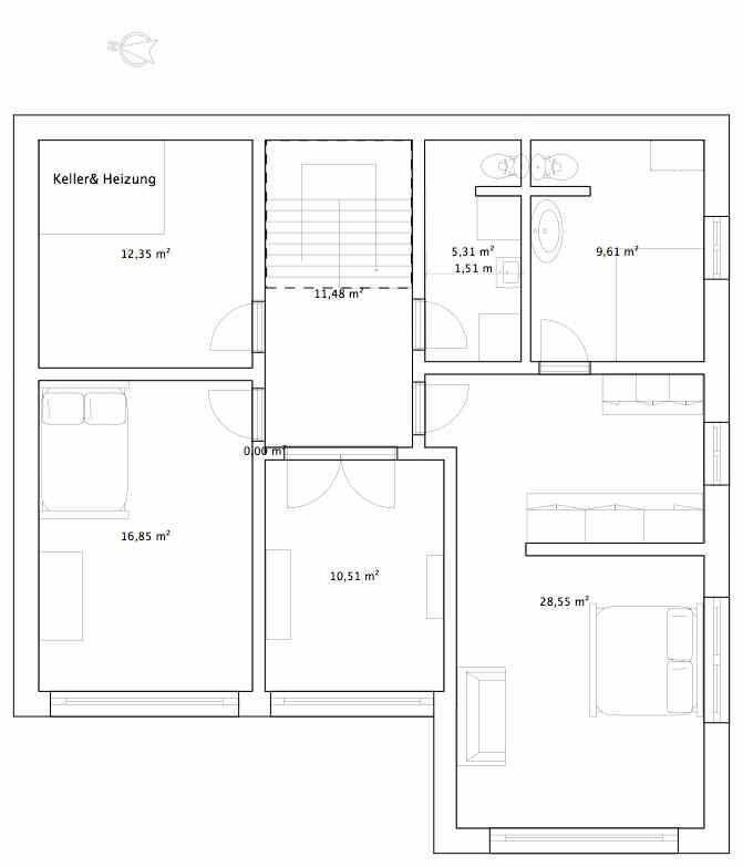

Dipl-WiING28 Dec 2013 20:28Hello again,
I was able to revise the draft after chatting with an old school friend (who is now an architect) over a beer and sorting out a few points, which I think improved the design (I then digitized the drawing at home).
Maybe someone would be kind enough to give some general feedback.
Pit
Upper floor:
Pit
Upper floor:
