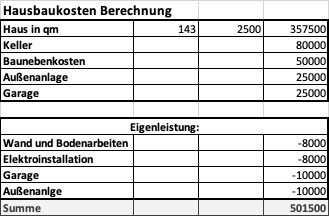

Upon further consideration, I realized that I incorrectly specified the living area because the stairwell area was included. It measures 5.94 sqm (64 sqft) per floor. This means the actual living area is about 143 sqm (1,539 sqft). Unfortunately, the first post cannot be edited.
Furthermore, the value of self-performed work has not yet been taken into account, which I estimate as follows. I would appreciate any feedback.
Table with house construction costs: wall and floor work, electrical, landscaping
[Bold]Explanation:[/Bold]
- We plan to do the painting and flooring (final finishing) ourselves.
- As an electronics technician specializing in energy and building systems, I will only need the materials; the other work will be done by myself at no charge besides my hourly rate.
- For the garage and landscaping, we also plan to contribute a lot ourselves and, if possible, avoid paying for craftsmen’s labor costs up to 90% (except for the garage roof truss).
The savings from self-performance were researched online from various sources.
So far, I’ve found figures on the internet with costs up to €2,200 per sqm (204 sqft). Is that unrealistic?
This results, when considering €2,200 per sqm total costs, in:
Calculation table of construction costs including house, basement, landscaping, and self-performance.
I would be really grateful for any feedback or corrections.
