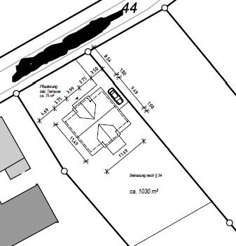

Development plan/restrictions: No development plan / rural area
Plot size: 1,030 m² (11,090 sq ft)
Slope: None
Floor area ratio: According to neighboring buildings
Plot ratio: According to neighboring buildings
Building envelope, building line, and boundary: According to neighboring buildings / approx. 10 meters (33 feet) from the street

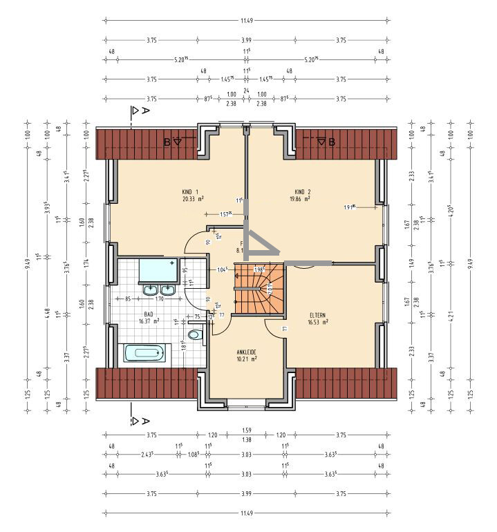

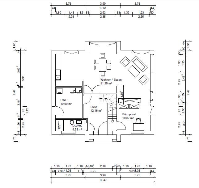

HausbauTiNa15 Oct 2018 21:30ypg schrieb:
I would rotate the toilet on the upper floor and place it under the sloped ceiling. That's all I have. How and where are you planning the wardrobe?Thank you very much for your input.
Why do you think it makes more sense to have the toilet under the sloped ceiling? Wouldn't that be structurally challenging?
The wardrobe might possibly be placed under the stairwell.

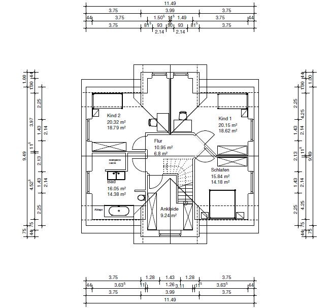

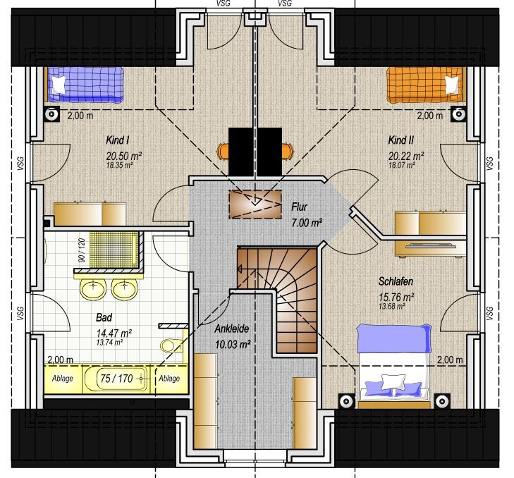

HausbauTiNa15 Oct 2018 21:38kaho674 schrieb:
Why are there two entrances to the bedroom? I think the one through the walk-in closet is enough. It saves unnecessary hallway space that no one really uses.
Sketch:
Sometimes you can’t see the forest for the trees. That’s a great idea! We will definitely consider it.
Of course, it’s important to ensure that the upper floor doesn’t feel too cramped.
Do you think the width of the shower is sufficient?
On which wall in the living room alcove would you place the TV?
HausbauTiNa schrieb:
Why do you think it makes more sense to place the toilet under the sloped ceiling? Isn’t that structurally challenging?I find it more harmonious to have the slope behind you. Also, this avoids awkward corners collecting dirt next to the bathtub, and the toilet paper holder, if desired, can be mounted more easily and accessibly on the wall.
The shower should be at least 1 meter (3.3 feet) wide, as this is a rough construction measurement.
HausbauTiNa15 Oct 2018 22:10ypg schrieb:
I find it more balanced to have the slope at the back. Also, there is no dirt corner next to the bathtub, and the toilet paper holder, if desired, could be mounted more easily and securely on the wall.
Shower with at least 1 meter (3 ft) width, since that’s a rough construction measurementWe have a knee wall height of 1 m (3 ft). As someone who is 1.90 m (6 ft 3 in) tall, I’m likely to hit my head there, right?
Okay, my wife has been trying to convince me for a while now that the shower should be widened by 15 cm (6 inches).
