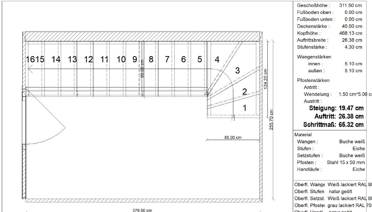

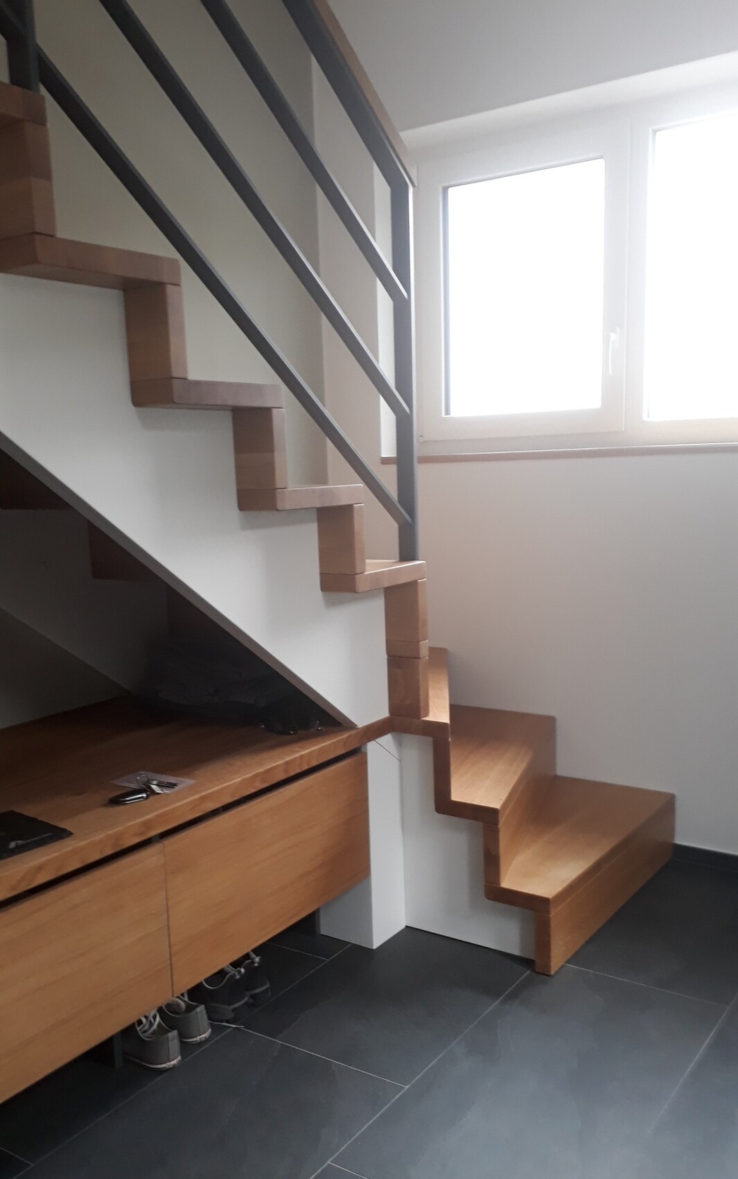

One more word about the staircase. We have similar dimensions in the entrance area (2.55m by 3.8m (8 ft 4 in by 12 ft 6 in) with a ceiling height of 3.11m (10 ft 2 in)) and a similar staircase. Here is the floor plan:
The staircase is really very, very steep! The rise and run are at the limit of what is even allowed. One more step would be better! We have 3.8m (12 ft 6 in) length. In your current plan, there are 3.64m (11 ft 11 in) – and even for that, you already have to notch out one step at the top in the hallway. That will not work like this. You need at least 3.8m (without a notched step!) or you have to add more steps going down toward the lower part of the plan (which means shifting the entrance door).
Under the stairs, we had a cabinet maker build us a shoe cabinet, and above it a coat rod. That’s enough for us – but we are only two people.

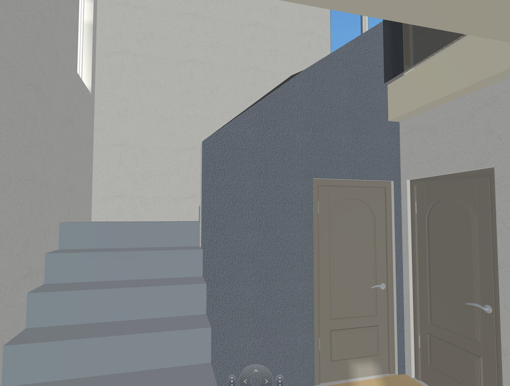

os24laenger3 Dec 2021 11:51I have now worked on the ground floor hallway, extended the staircase (it was democratically decided that the staircase should remain in the hallway), made the hallway larger, and increased the size of the technical room. The toilet is placed under the staircase (minimum height is 2 m (6 ft 7 in)). The toilet wall also serves as the boundary to the terrain.
In my opinion, it doesn’t look bad.
os24laenger schrieb:
Toilet under the stairs (minimum height is 2m (6 ft 7 in)). The wall of the toilet also serves as the terrain.
In my opinion, it doesn’t look bad.I assume you used a similarly, let’s say, “unconventional” calculation model of the stairs for the visualization as shown in the drawing.https://www.instagram.com/11antgmxde/
