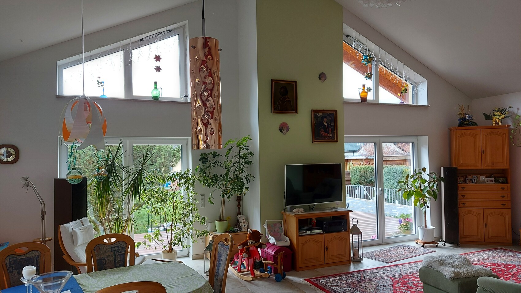

Ruth+Dennis10 Jan 2022 21:45Nida35a schrieb:
I would orient the open gable of the pitched roof to the south, facing your own property and not the neighbors. In summer, sun protection is necessary, but otherwise there is a wonderful amount of natural light in the room. For example, our view from the open kitchen to the south.That looks very nice. Unfortunately, orienting the gable to the south would cost us a photovoltaic system similar to a bungalow with a roof surface facing south and would also cause shading... with an open ridge, meaning a view of the roof rafters and a large window front, we would already be satisfied.Ruth+Dennis schrieb:
Client Requirements Requirements are more about your needs rather than the construction company's scope of work.
