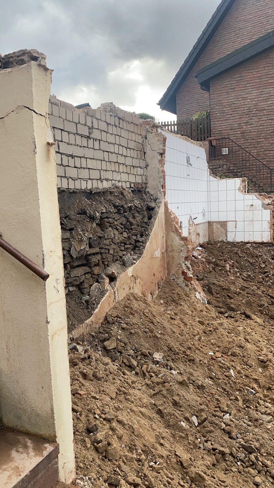

moooooo322 Feb 2022 15:05So, we have now left the wall standing; by the way, no one else had pointed this out to us, which would have been unfortunate considering the space needed for the construction site in the garden. Maybe that’s something our architect could have mentioned? 🙂 How else would you know?

moooooo322 Feb 2022 15:21haydee schrieb:
Oh, now you can really see how small the building gap is.
How does it feel?
I cried when the excavator took down the first beam. It felt so final. Yes, the plot is only 388 sqm (4179 sq ft), but we are trying to get a slightly larger garden by building a shorter house (11 m instead of 14 m (36 ft instead of 46 ft)). Maybe we won’t stay there forever. Everything is very densely built.
It’s kind of strange. My grandmother currently lives in the neighbouring house, and my grandfather or great-grandfather even laid those old grey bricks themselves (a professional at work, not me), so it’s a part of family history somehow. But I think it’s better that we build something new there than have a stranger live there in 5 or 10 years 🙂 I believe everyone there tries to think that way. But yes, at first it does feel odd.
You’re basically tearing down 150 to 200 years of history. But it’s not really salvageable.
Oh, and the plot extends all the way to the adjoining wall (with the window that has to be closed off), including the stairs. We’ve left that for now, it can still be knocked down later by ourselves.

moooooo322 Feb 2022 15:45K a t j a schrieb:
And it also immediately solves the door issue for the utility room. I’m working on fixing that 🙂 I’ll upload it shortly!For us, it wasn’t just family history. So many people in the village came and went.
What has to be, has to be.
Dry rot, fire damage in the floor structure, and so on, plus all the agricultural outbuildings. Every generation made changes. The house was simply finished, and the farming no longer exists.
