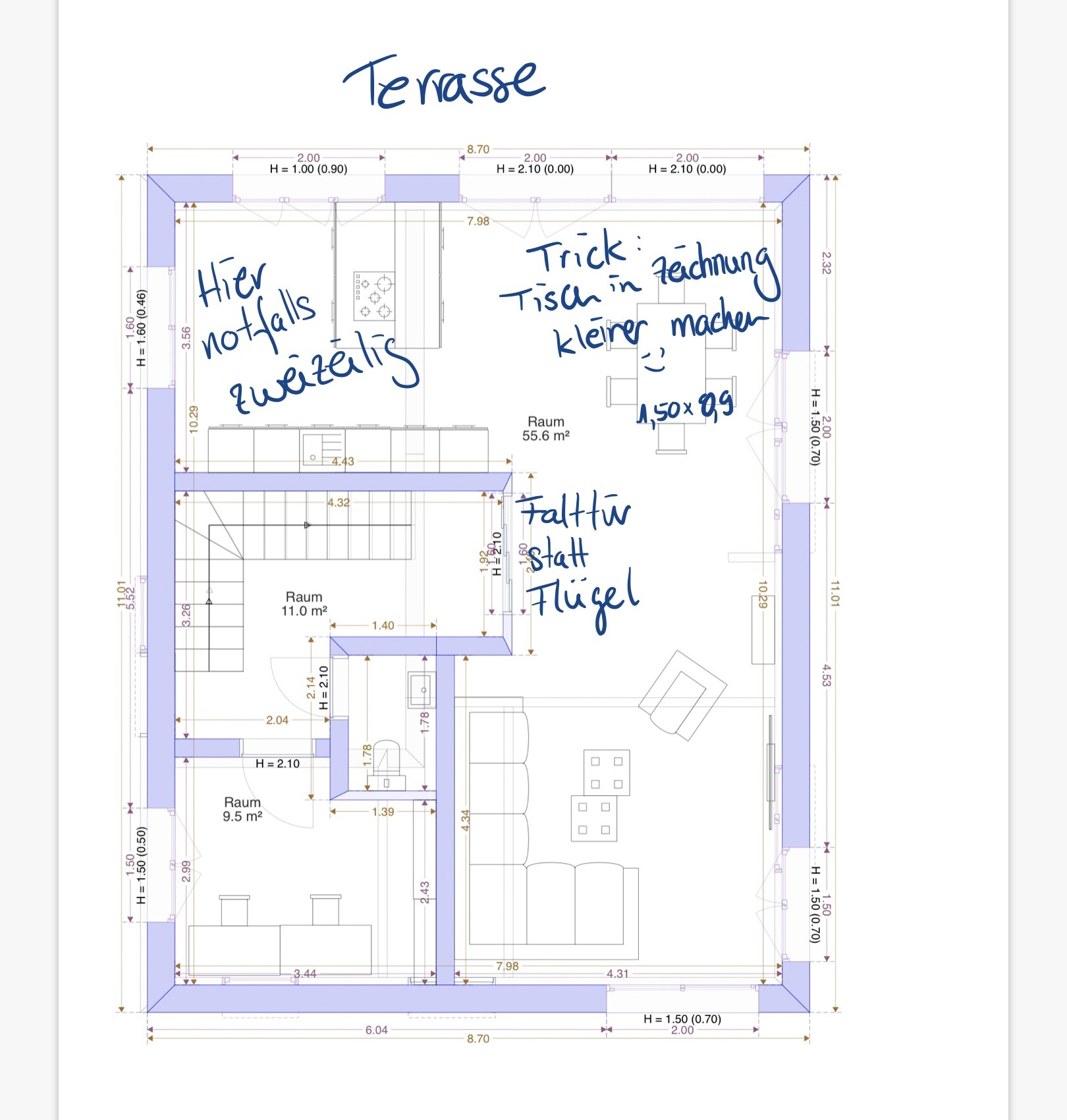

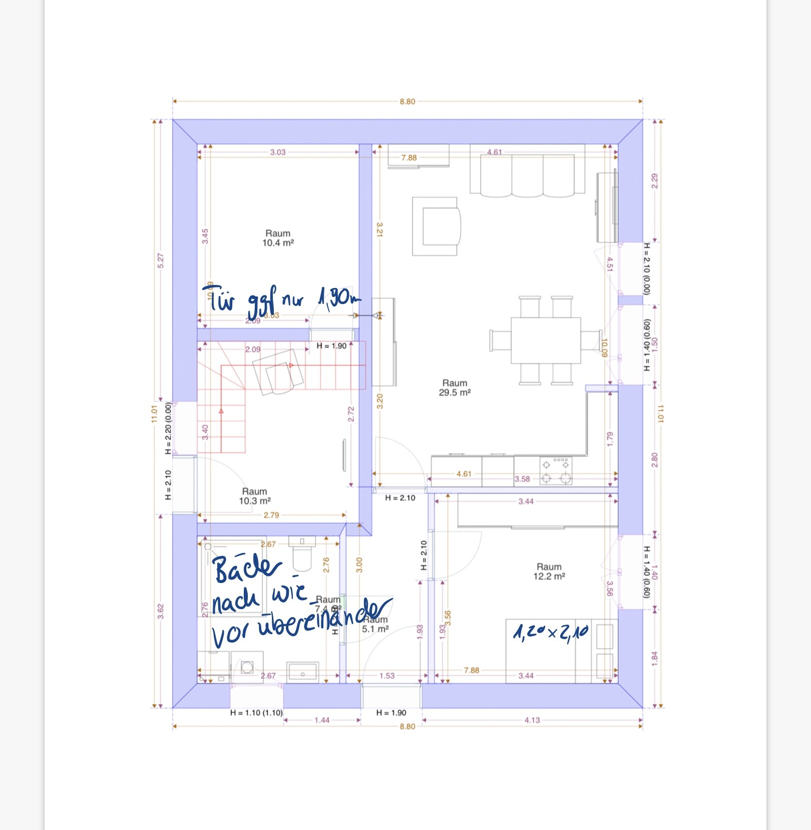

moooooo324 Feb 2022 07:40K a t j a schrieb:
More character with a 50° roof attic?
[ATTACH alt="EG-hang-v1.jpg"]69492[/ATTACH]
[ATTACH alt="OG-hang-v1.jpg"]69495[/ATTACH]
[ATTACH alt="DG-hang-v1.jpg"]69494[/ATTACH]
Okay, the washing machine only fits in the bathroom now and the guest bathroom on the upper floor is quite narrow, but the balcony is fantastic, isn’t it? 😉Hopefully I’ll get to reply later this morning.M
