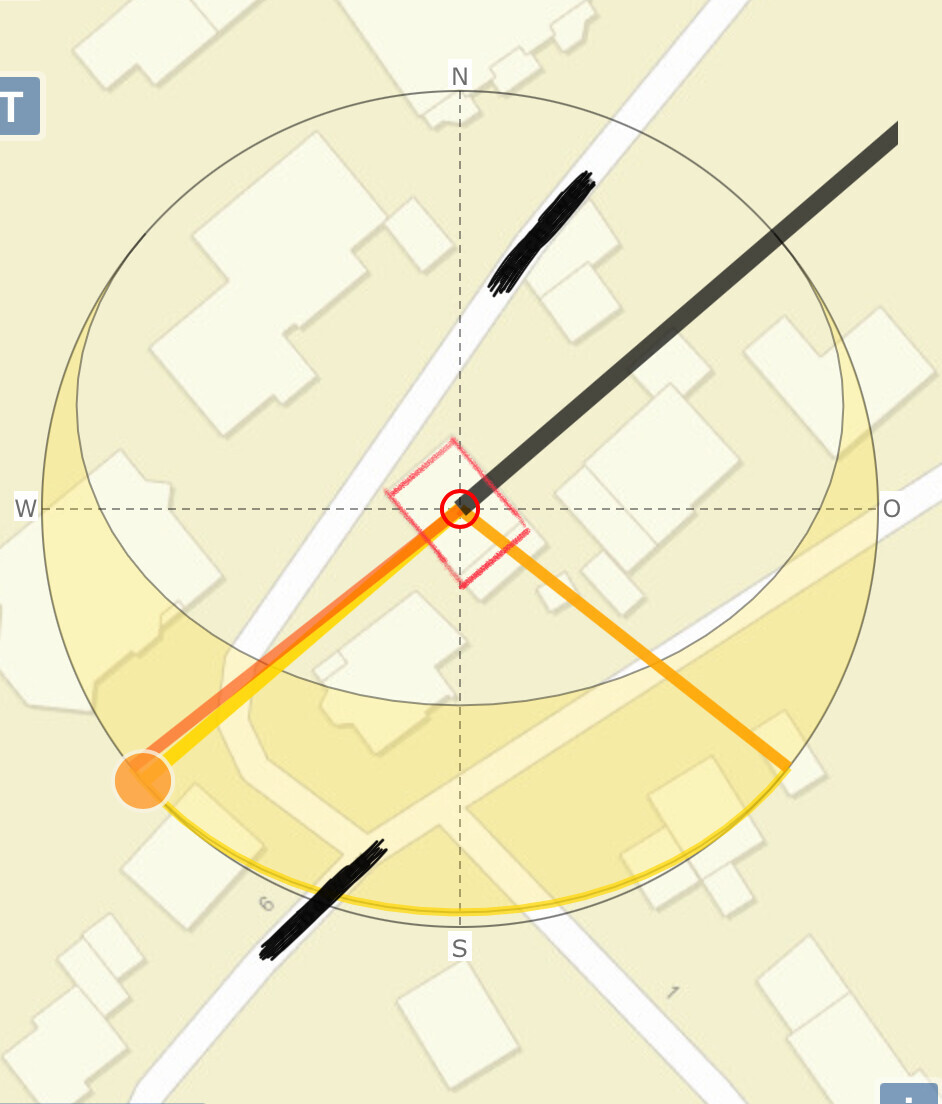

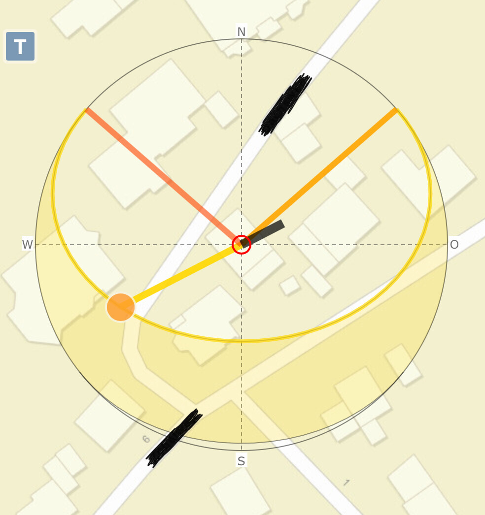

I have been reconsidering the room layout and the sun path.
Map view with compass circle, red center point, and yellow/orange line path to the center.
Map view: compass circle, center marked, orange lines from SW point through center to SE point.
As mentioned, the plot itself is not very attractive, quite built up. However, the view to the west between the two houses is great (skyline), and to the northeast as well (tree tops).
The red-outlined lines roughly indicate the new house.
For the living areas on the ground floor, I am thinking that the living room should be positioned at the front, so it still gets some sunlight in winter, right?
How should the windows ideally be arranged in our living room? The architect suggested narrow windows on either side of the TV, but wouldn't that cause glare? A corner window (with a support column since it’s expensive) would enhance the view, but most of the sunlight naturally comes from the southwest. Would it be better to have a “standard height” wider window? A wider floor-to-ceiling window? Several distributed windows? It would be great if some space for furniture could be left as well. In my opinion, the window at the dining area can be removed so that a cabinet can be placed there instead.
