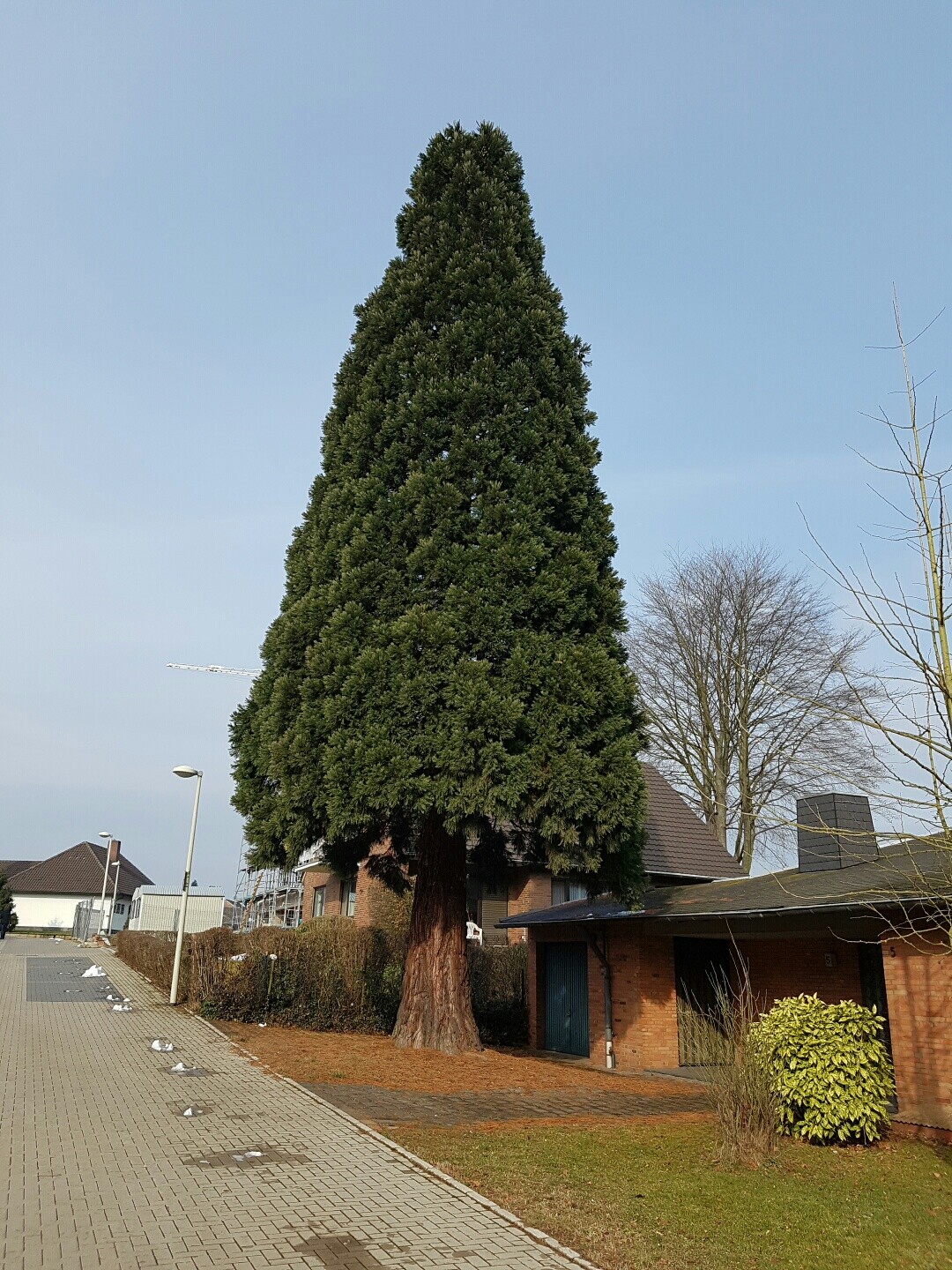

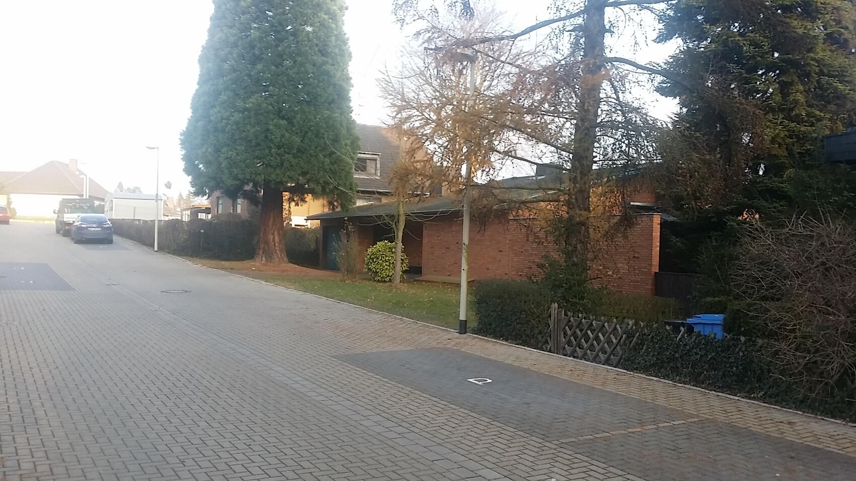

R.Hotzenplotz17 Feb 2017 00:04Hello,
I am considering a plot with an existing building.
24 meters (79 feet) wide
44 meters (144 feet) deep

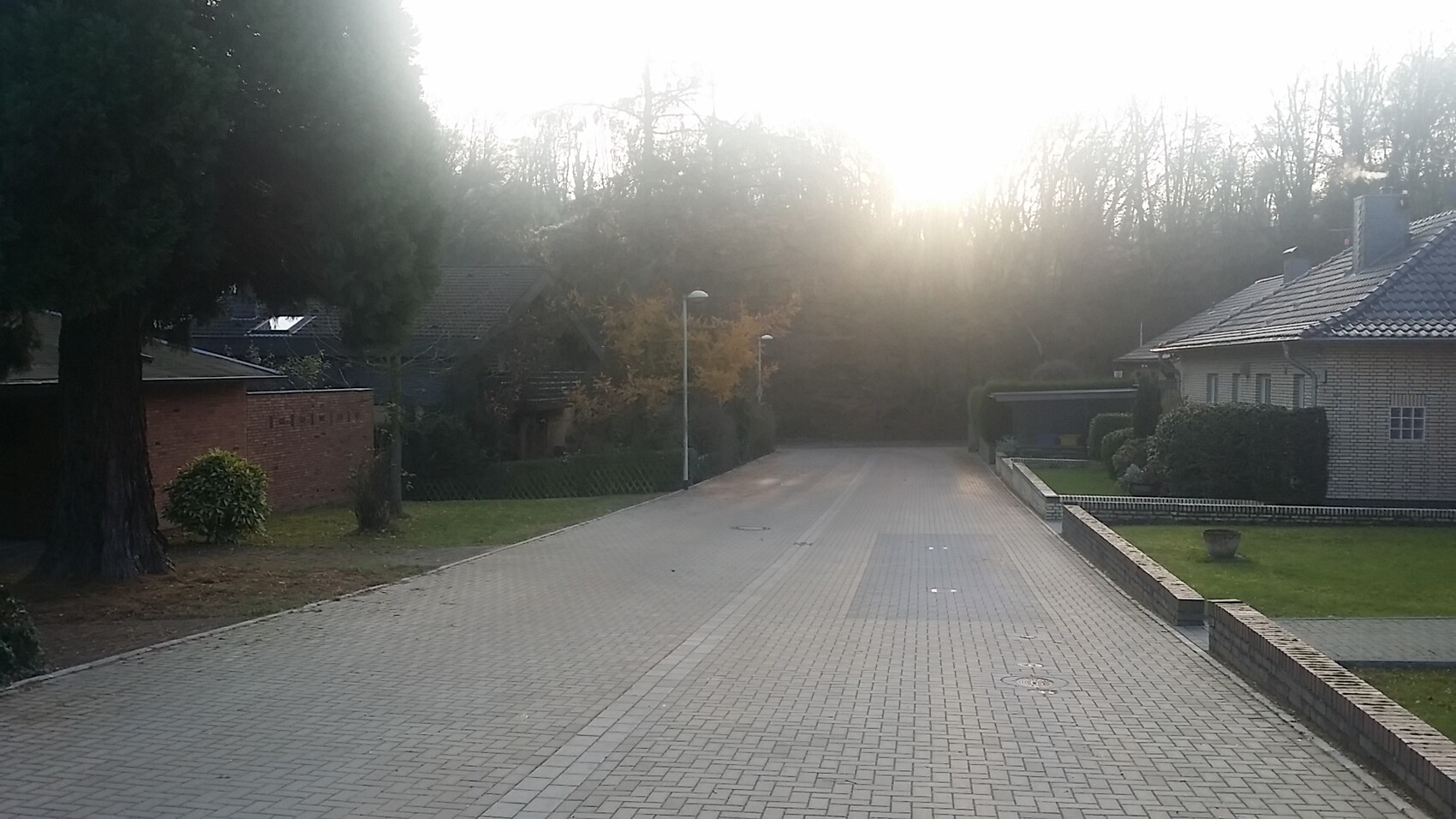

Here is an impression of the plot and its surroundings.
Development is permitted according to Section 34.
The building authority has indicated they would approve two full stories with a flat roof if the design fits the surroundings. In the nearby neighborhood, which is not shown in the photos, there are also some newer houses with flat roofs and two full stories.
No further information is provided by the building authority. They want to see an architect’s design first and then conduct a building consultation. However, I cannot wait that long, as the plot will likely not be reserved for me indefinitely.
Therefore, my question is: what would be possible on this large plot with the current low building in place and two full stories? We are imagining a house with about 200 square meters (2,150 square feet) plus usable space in the basement. We are not really fans of stepped floors in two-story buildings but would prefer two full stories. This means the 1,085 square meter (11,679 square feet) plot is very large compared to the building volume.

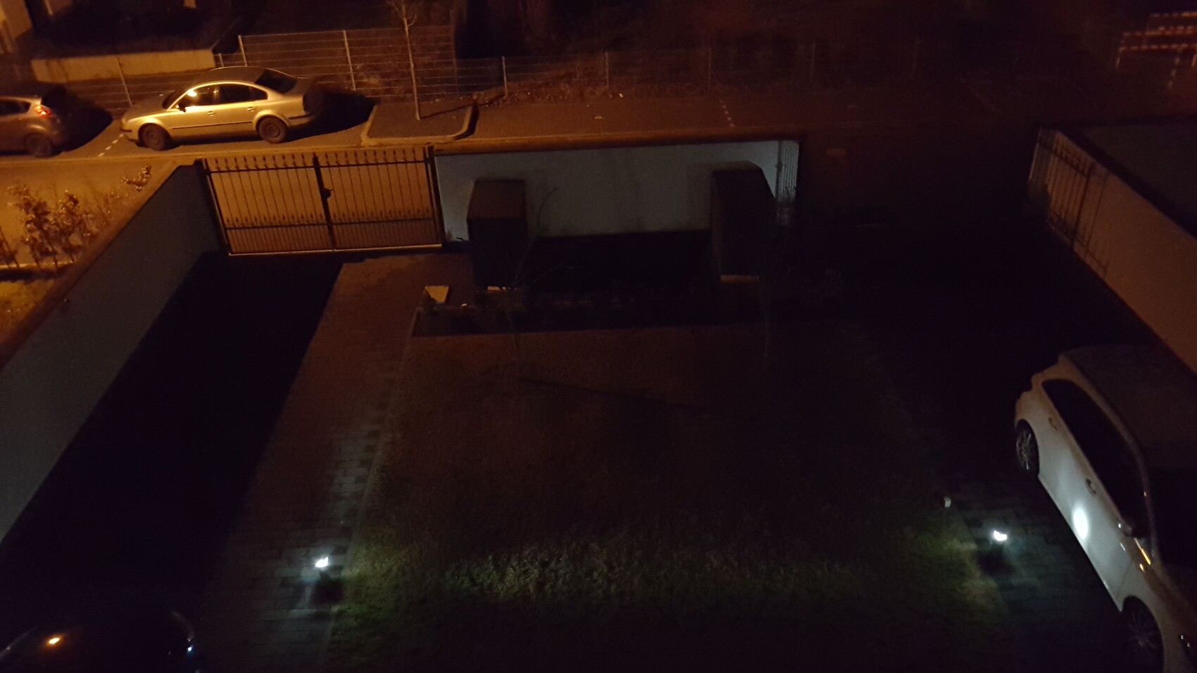

At the same time, we place great importance on privacy. Given the development in the neighborhood, I do not expect to be allowed to build a boundary wall around the property like we have at our current home:
It’s a bit dark but you can see it.
We appreciate being able to keep people off the property when the gate is closed. That already provides good privacy. I doubt that a roughly 2-meter (6.5 feet) high wall would be permitted on the plot we are considering, judging by the street there, right?
Then our minimum requirement would be that the plot is fully enclosed from left to right starting at the house so no one can enter the garden from the street (not even by climbing a small gate or similar). It would need to be a continuation of a wall like the existing old building. I would probably see this more on the left side, where the tree that we find very worth preserving stands. Maybe the garage would be on the right side.
But does all of this fit within our framework for a house? Or is the plot simply oversized? Clearly, it is large at 1,085 square meters (11,679 square feet). However, it is affordable. We have no problem with a large garden. We have been searching for about three years and have not found anything. This plot would simply be great in terms of neighborhood, location, price, space, etc. But can we make it work like this?

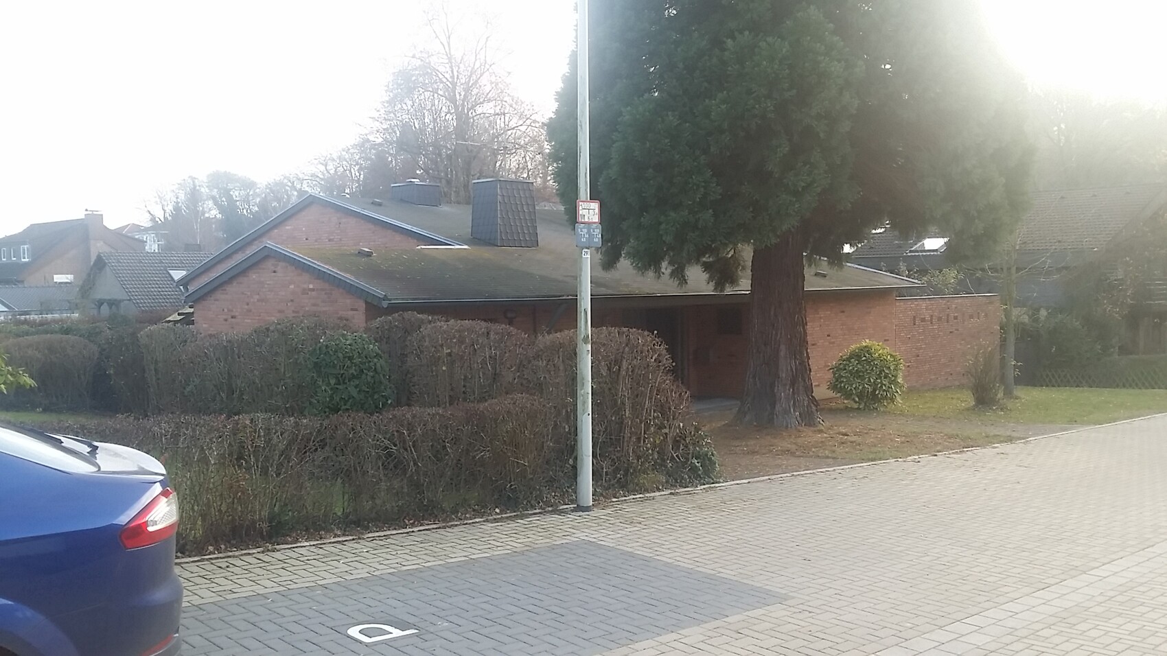

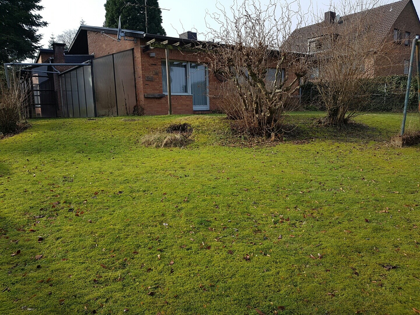

The term "existing building" refers to the approximately 50-year-old bungalow – which, except for the thermal insulation standard, probably still has a solid structure. Should it stay as is, be renovated/expanded, or removed?
An aerial photograph could complete the overview.

R.Hotzenplotz17 Feb 2017 08:17I can’t see any of the pictures...
