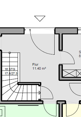

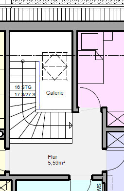

Attached is the stair and hallway area from the Juno plan, somewhat configured but already replicated.

Well, the staircase is basically different, which affects all floors as well as the hallway and rooms upstairs. Or not?
Attached is the staircase and hallway area from Juno, somewhat configured but already replicated.
Yes, the staircase is somewhat different. However, the difference in the layout of the rooms is rather small in this case.

K a t j a schrieb:
Yes, the staircase is a bit different. However, the difference in the layout of the rooms is rather minor in this case.
Yes, the issue was probably more related to the staircase affecting the other floors as well. Additionally, the rooms in the northeast become smaller.
