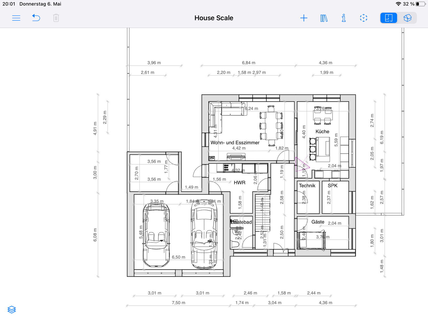

we are currently working on the floor plan for our house.
We would like to hear your opinions regarding the ground floor. What would you change and why?
Is the utility/technical room too small? Part of the laundry/utility room could also be used for the electrical connections.

What do you not like? Why? Utility room is oddly shaped and the technical room is probably too small

Floor plan of a house: living/dining room, kitchen, guest room, technical room, utility room, pantry, double garage.

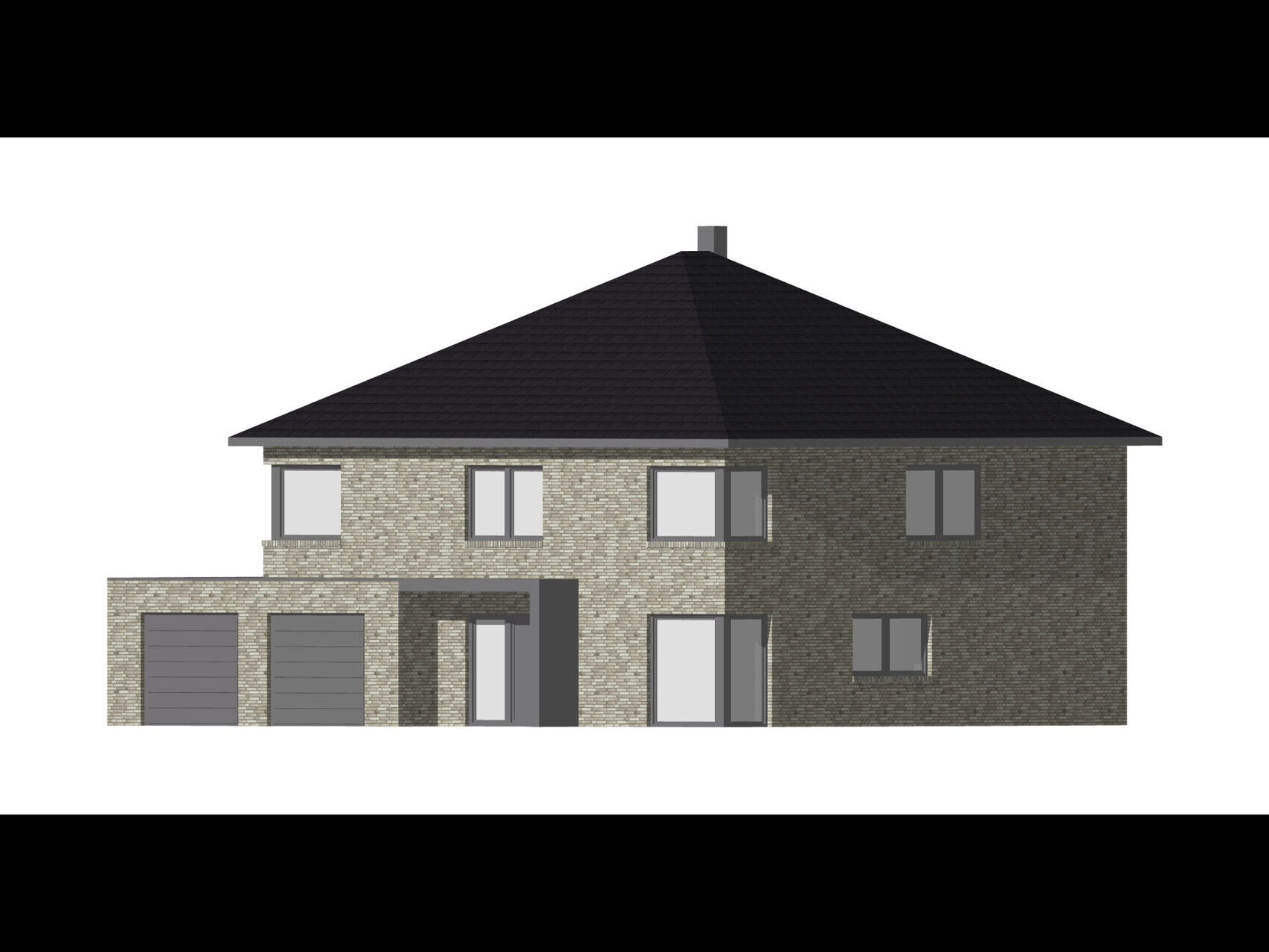

Two-story brick house with dark hipped roof and garage to the left.

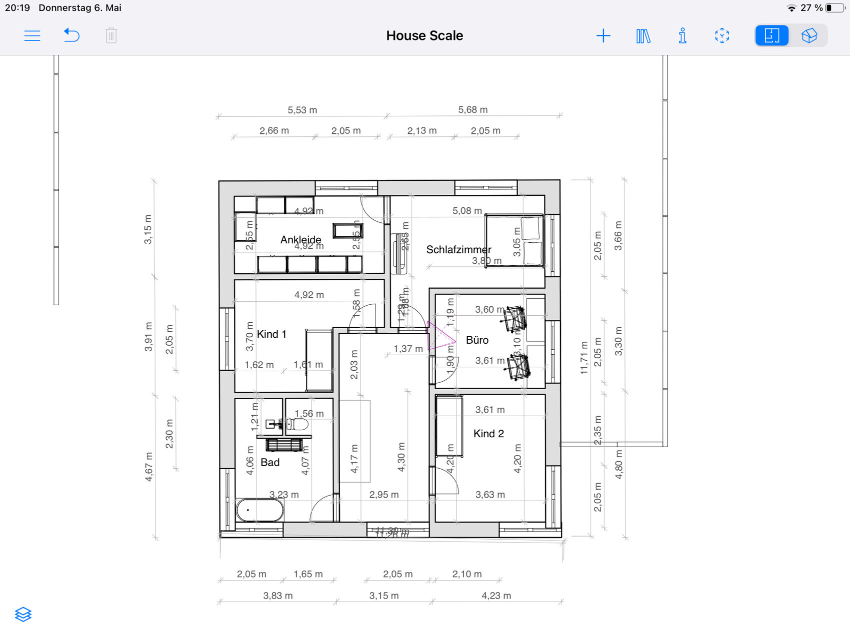

Floor plan of a house: bedroom, walk-in closet, office, bathroom, two children’s rooms and dimensions.

Could you please complete the questionnaire fully? Many parts have been left out. All points are justified. You are omitting essential information.
Acof1978
6 May 2021 20:25
At first glance, I can immediately say that the technical room is too small. Otherwise, I agree with ypg.
Gudeen.
6 May 2021 20:40
The furniture is drawn in far too tightly; it just doesn’t fit that way (for example, in the kitchen).
And do you climb over the countertop to get into the pantry? Or did I misunderstand something? 🤨
Also, the staircase is one meter (3.3 feet) too short, if I’m interpreting the measurements correctly.
11ant6 May 2021 21:25
Sasi1901 schrieb:
Utility room oddly shaped and technical room probably too small
Then the utility room fits perfectly with the rest of the rooms; in fact, the whole house is oddly shaped. I would even add, to a remarkable extent.
thoughtless86
6 May 2021 21:59
The garage is nice... unfortunately, I have to agree with the others, the room layout hardly fits at all, and I still don’t understand the pantry situation either...
