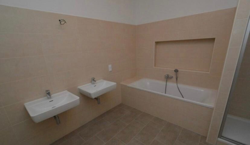

Regarding the standard equipment again:
This is a standard bathroom in a 120 sqm (1300 sq ft) apartment in Vienna costing 1.3 million euros.
A 1200 m2 (0.3 acre) plot and a budget of 350k does not reflect typical conditions in Vienna. The picture shows social housing from 20 years ago.
