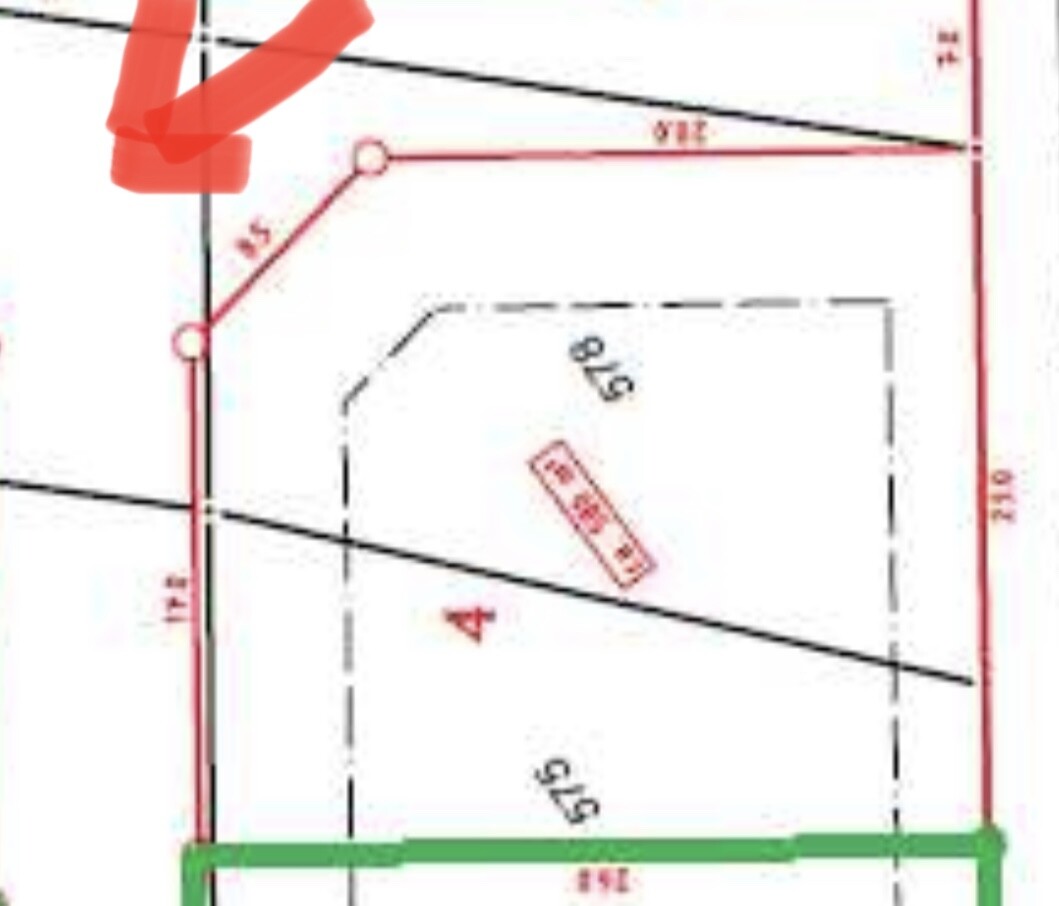

Unfortunately, I only have the sparse drawing attached. To the left of the plot is a neighboring property, above and to the right is a street, and on the right a dead-end street where there might eventually be an expansion of the residential area.
We just noticed that the planner marked the orientation incorrectly on the floor plan. North is basically top left, not top right—is that clear?
As for the furniture layout, we haven’t reached that point yet, unfortunately.

Floor plan with dimensions, red outline and black lines

In fact, Child 1’s room is the bedroom, and the bedroom is Child 1’s room. The orientation was drawn incorrectly by the planner. The planner’s arrow currently points, so to speak, to the east.
We hadn’t noticed this until now.

Now is also a good time to work on your site plan and sketch everything out, including sun position, shadows, and terrace.
That’s how you get to know your site, including the dimensions, without having to visit it all the time.
