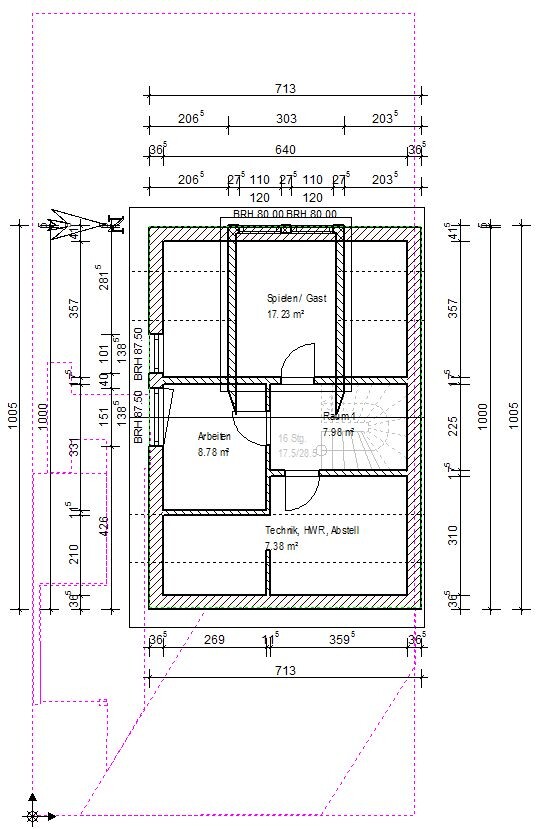

we are currently in the middle of planning the floor plan. Unfortunately, I don’t have the architect’s drawing yet, but I wanted to get your opinions already. I’m afraid the house might be too dark because of the north-facing side, so I actually want to include as many windows as possible.
Thanks in advance!

Can I plan the windows better so it stays nice and bright? And I don’t like the bathroom 100%, would appreciate tips.

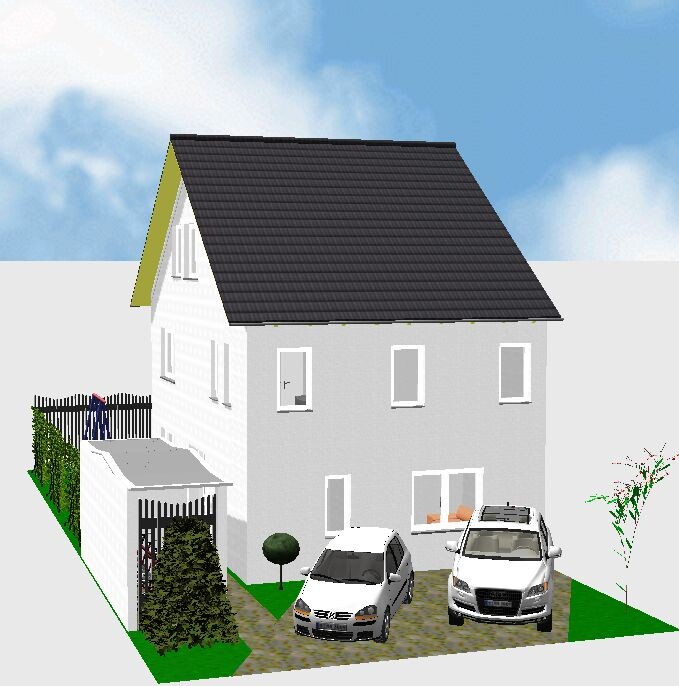

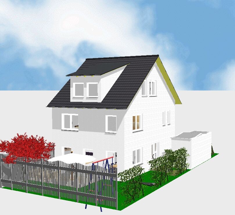

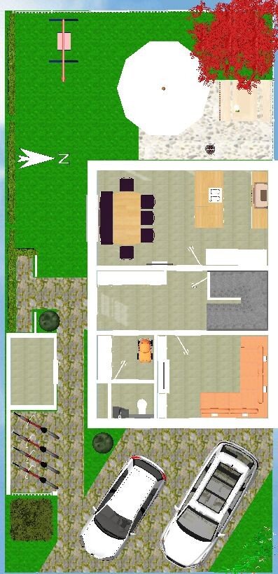

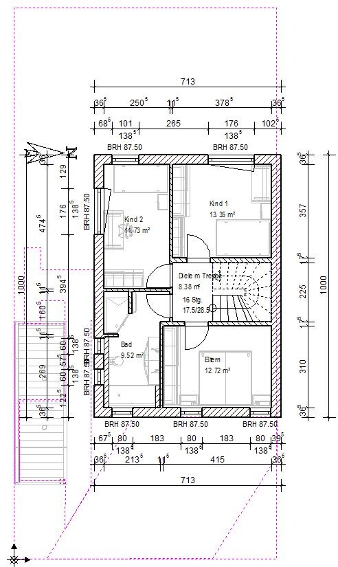

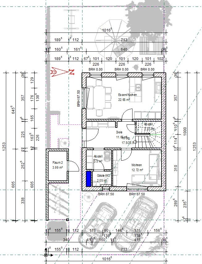

I once created a design for Goalkeeper with a side entrance, measuring 7.13 x 10 m (23.4 x 33 ft), but with the upper floor as a full story. I could also imagine this floor plan being a bit longer (which would benefit having separate living rooms), and the question is whether two full stories would generally be allowed.
For plots that are 10 m (33 ft) wide, I find it less practical when a 3 m (10 ft) strip is completely taken up by a garage. How do you, for example, cleverly get new plants into the garden? Where do you park bicycles? They won’t fit alongside a car in a 3 m (10 ft) garage, and so on.
However, Goalkeeper has the north on the right side of the plan. He didn’t realize it that way. But just as a suggestion.

I once designed a version of the Goalkeeper with a side entrance, measuring 7.13 x 10 meters (23.4 x 32.8 feet), but with the upper floor as a full story. I could also imagine this floor plan being a bit longer (which would benefit the separate living room), and the question is whether two full stories would generally be allowed.
For 10 meter (32.8 feet) wide plots, I always find it less than ideal if the 3 meter (9.8 feet) wide strip is taken up by a garage. How would you, for example, cleverly access the garden later with new plants? Where do you park bicycles? They won’t fit alongside the car in a 3 meter (9.8 feet) garage, and so on.
The Goalkeeper’s north side is to the right in the plan. He didn’t implement it that way, but just as a suggestion. Thanks very much for the floor plan. Unfortunately, we are only allowed one full story. The knee wall on the upper floor is 50 cm (20 inches). We won’t have a garage, maybe a carport later. The 6.5 meter (21.3 feet) width we have planned for the living room seems ideal to me. But I will still try the side entrance again, since many recommend it. Maybe a solution can be found.
Marc1990 schrieb:
But I will still try the side entrance again since many suggest it. You shouldn’t try to do it yourself; instead, let your architect handle the planning. You only need to note what is important to you—they will take care of the rest.
Why do I keep seeing “maybe a carport later”?
Include it in the plan right from the start; with this plot width, there is no room for adjustments later. Especially the issue of natural light on the ground floor needs to be taken into account.
With a planned floor area of 112 sqm (1205 sq ft), a capable architect can definitely deliver a solid result!

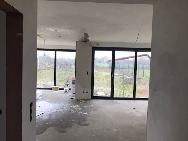

Your wish for a large open living/dining/kitchen area seems somewhat oversized to me. That’s where the ground floor bedroom comes back into play—this would reduce that area somewhat, which would actually be beneficial. Take a look at the attached picture. That’s the view into the living/dining/kitchen area with lots of natural light. The extended dining area allowed for even more windows and light. I actually thought that was the best feature of that building. I didn’t feel that it was too small. Imagining the finished house I personally visited with your floor plan in mind (where you can see all the way from the entrance through to the window front of the living room), the windows would appear progressively smaller visually, and the ceiling would feel very low and oppressive. The conclusion: put the entrance on the side; there’s no other way…
