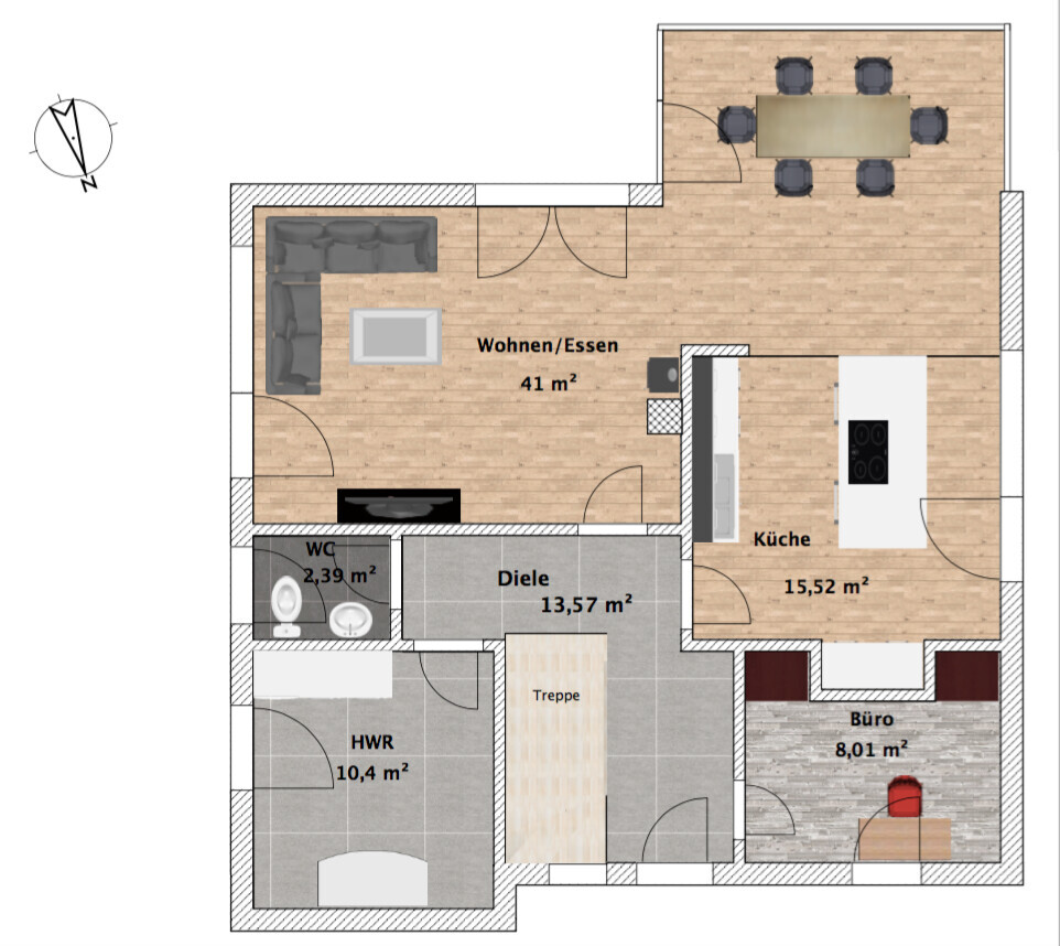

Based on the suggestions here and our dissatisfaction with the position of the fireplace, we’ve made some adjustments. What do you think? I’m already ducking.

j.bautsch19 Dec 2016 13:18I just don’t like this narrow spot at the staircase. I would really reconsider it or try to simulate it in some way.
stevenprice19 Dec 2016 17:28So, we don’t want a huge wardrobe anyway. The staircase is open, so you can also place a shoe cabinet or something similar underneath it. I don’t even need to simulate this because we have already seen this exact entrance area several times in a show home.

You should include the southwest corner of the kitchen in the hallway. Align the hallway wall so that the kitchen unit can also be installed.
Then I would move the tall kitchen cabinets to one side—having them near the door is not ideal, possibly along the exterior wall? This gives you more flexibility when furnishing the office/storage room.
I would strongly advise against using an open staircase as a coat storage area. Dirt tends to fall through the open steps, and it always looks, always looks, always looks untidy—and it will always remain that way. It’s better to enclose or box in the bottom of the staircase, install a door, and use the space as a coat closet. You have enough room for this if the corner in the hallway is removed.
Regards
