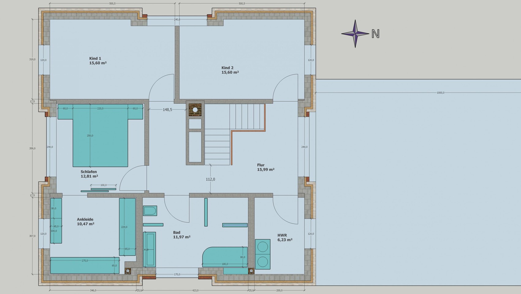

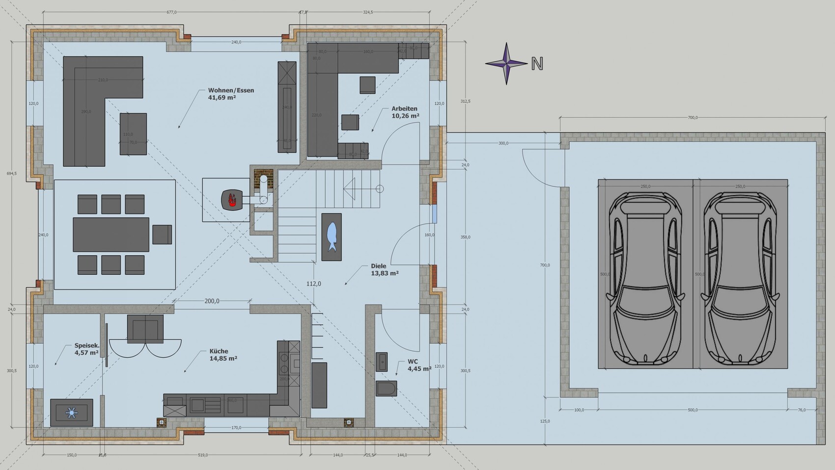

You are stuck... The designs in #22 and #1 are very similar, while in #11 the "old" designs at least looked different – not judging whether better or worse, but you can clearly see a significant difference.
Hausbauer110 Oct 2017 00:10Fuchur schrieb:
So, I’m back.
Countless new drafts have been started and, sooner or later, discarded due to unsolvable follow-up problems.
Result: None of the drafts include a properly accessible half-landing staircase.
Options:
1. Extend the house about 90cm (35 inches) in the east-west direction. This would result in a nice ground floor layout. The upper floor planning would be more challenging but manageable. Probably significant additional costs and a living area exceeding 200m² (2,150 sq ft), both of which are actually unwanted.
2. Abandon the house template and the general contractor (GC) and start over with an architect. Quite conceivable, and the more I read about the individual trades, the more likely this becomes. Some special requests are either not offered or reluctantly handled by the GC (e.g., electrical work), while others come with unrealistic markups, so outsourcing certain trades might make sense. Still, I want to continue with my own planning for now, especially since my initial search for architects hasn’t produced any “aha” moments yet.
3. Forego the half-landing staircase. Although this thread nearly revolved around this topic, it was never a must-have for me. I would find it stylish, but no more than that. For example, the cloakroom area is more important to me. So I started there initially.
Main changes/improvements:
- The passageway to the garage was removed, thus the garage is now completely separated from the house.
- Washer and dryer permanently moved to the upper floor.
- Office moved to the north side, towards the better view and to avoid sun glare during computer work.
- Kitchen enlarged and door relocated for much more relaxed planning; aquarium moved to the opposite wall.
- Guest toilet moved to the southeast, larger than necessary; the second shower is still under consideration, the visual appearance of the passage in the finished house remains uncertain.
- Slight increase in the depth of the living area, which should be nice in the family space used most.
Other notes:
- I haven’t yet worked on the window locations in the new rooms. Since no 3D views have been created yet, it remains to be seen if the offset of the kitchen window will have more positive or negative effects.
- What do you think about the width of the corner glazing in the dining area? My research did not reveal any recommendations, and I chose 2x 1.50m (5 feet) somewhat arbitrarily.
- In the new plan, the HVAC room, guest toilet, kitchen, and bathroom are stacked vertically. According to the GC, this makes no difference, but why solve problems if they don’t even arise in the first place?
- The direction of the staircase will probably be reversed, but this does not affect the other floors.
- The length of the staircase should match the stride length; there might still be room for an additional step if needed. Having tested and measured several staircases, I’m almost beginning to think that the standardization is overdone. Even when exceeding the “ideal” stride length by several centimeters, the staircase was still very comfortable to use.
- We have no problem with having the walk-in closet separated. A direct connection to the bedroom is nicer but inevitably leads to unacceptable compromises in the floor plan.
Regards
Daniel40m² (430 sq ft) hallway. Good grief. Some families live in that much space.
RobsonMKK schrieb:
Who did the calculations if the planning is DIY?The basic house comes from a general contractor. I submitted the design from #1, and from that, a cost estimate with markups was prepared.

We took the advice to heart and now have an architect. After several drafts and revisions, we have reached a stage where we are about to approve the preparation of the building permit / planning permission documents. At this point, no compromises are included for us.
The final ceiling height on the ground floor is still open, but there is room for an additional step between steps 7 and 8 if necessary. I have not yet created a 3D view but will provide one in the next few days if needed. For legal reasons, I do not want to share the architect’s plans here. For clarity: the house has a pitched roof and a covered entrance area extending from the garage roof. Access is from the east, as shown at the beginning. The ridge line on the ground floor is dashed so that the chimney does not intersect it.
Edit: The kitchen units are placeholders representing minimum space; of course, a detailed design is still to come.
