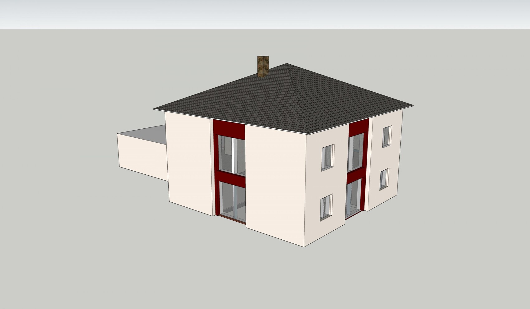

The wood stove won’t be anything large, more like as small as possible and, of course, placed against the wall. Since we haven’t finalized a model yet, I’ve used fairly generous dimensions to ensure the clearances and passage widths won’t end up too tight. Also, at the table, the 7th chair will be missing about 95% of the time, and the table itself will be smaller. The lines basically show the maximum movement area or radiation zone of the stove, where there should be no overlap with other furniture.
Yes, the bed is an oversized waterbed, and that will stay. We also deliberately designed the dressing room without a central entrance.
By the way, the children’s rooms are located in the west, not the north. One of them also has a south-facing window.
Maybe a question for the experts:
We haven’t decided on the roof yet. The architect suggests a 20° roof pitch, but I would prefer 30° due to wind resistance, choice of roof tiles, and solar panels. Here I have drawn it at 25°. What do you recommend? I can’t really judge the appearance of the alternatives in reality.
Instead of a pyramid roof, maybe a hip roof?

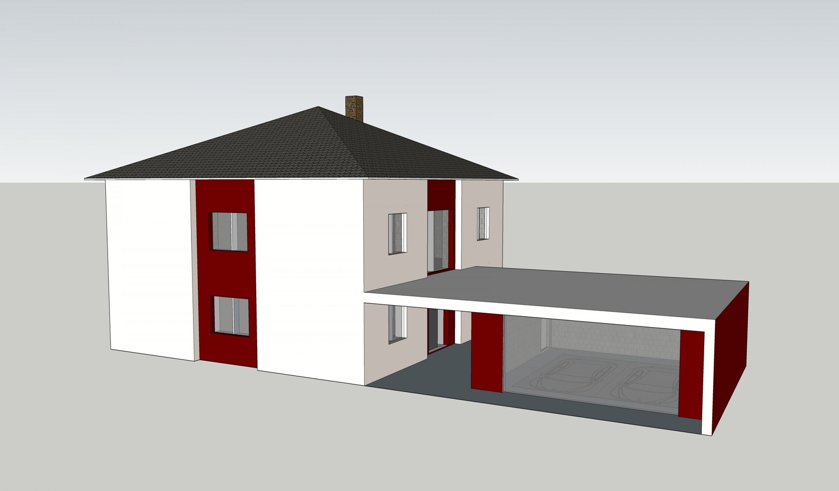

Fuchur schrieb:
quick & dirtyThe "duplication" (setback and dark red) is hopefully not to be taken seriously.Fuchur schrieb:
I drew 25°. What do you suggest? I can't really judge the appearance of the alternatives in real life.
Instead of the tent roof, more like a hip roof?The difference between a hip roof in general and a tent roof specifically is basically whether or not there is a ridge. I find ridges shorter than 2 m (7 feet) visually (to put it kindly) "not worthwhile." And I would not "create them artificially" — meaning a ridge only if there is a corresponding difference between the longer side and the shorter side. For the pitch question, my recommended reading is: https://www.hausbau-forum.de/threads/Walmdach-ideale-Neigung.25192https://www.instagram.com/11antgmxde/
