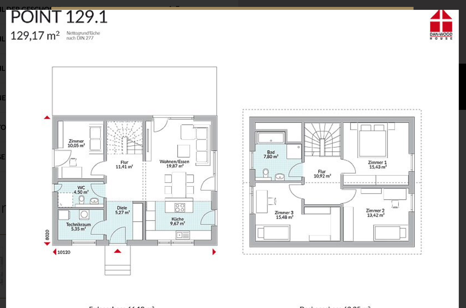

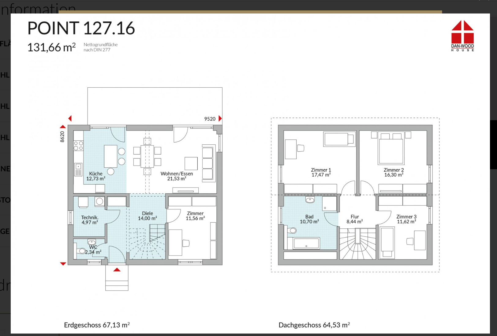

Reluctance schrieb:
Unfortunately, I see it the same way. I can’t part with any of them. They’re all classics... not some cheap novels or anything.Another bookworm here
Not even my mother-in-law throws away books, and she’s quite minimalist
I read fewer classics, but it’s not trash either. And my cookbook collection too
R
Reluctance19 Feb 2019 21:26haydee schrieb:
Take a look at Schwörerhaus. ....
For example, plan E15-124.4 or E15-124.3
I like the ground floor E15-137.4 where the study is designated as the utility roomThat’s pretty much in line with what I’m looking for, thanks for the tip.
My neighbor had a Maxime 300 and a piano... just take a look at that. Or the Maxime 305... just for size comparison.I like that too, although the staircase is again in the entrance area... I’m starting to think I’ll have to accept that.
But who said a conventional layout in the attic is best? I agree: you’d have plenty of options.
And if you don’t have kids, you could just turn the hallway into a living area anyway.Yes, you could do a lot with the bookshelves and so on. But I’m still hesitant to make it a final decision right now.
Then take my house Where can I find that?
