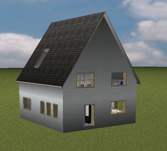

I didn’t know until now that you can build a 55° roof pitch. It actually looks quite awkward:
Two-story house with dark gable roof on grass; windows showing interior rooms.
Has anyone ever seen this in real life?

face2622 Feb 2019 10:26
kaho674 schrieb:
I didn’t know it was possible to build a 55° roof until now. It looks really awkward:
Has anyone actually seen one in real life?
Are you serious? Wondering if anyone has seen that before? Have you ever walked through an old town?
I’ve seen that quite often, and I’d even say with even steeper roofs. Whether you like it or not is another matter, but I’ve also seen renovated houses with similar roofs that incorporated a very modern style... I wouldn’t buy one myself, but it doesn’t look that bad.
11ant22 Feb 2019 15:35
With roof pitches between 35° and 55° and a knee wall height of 120cm (4 feet), dormers are generally less necessary, and other types of roof windows don’t make much sense either.
Above approximately 42° to 48° (which feels like about 45° due to perspective distortion), in my opinion, it’s better to avoid floor-to-ceiling or otherwise very tall vertical windows on the gable ends; otherwise, the vertical emphasis becomes too strong.
Whether a village scene must be preserved exactly as it looked during the early days of the railway is something I question. The past cannot be brought back.
22 Feb 2019 16:05
kaho674 schrieb:
I didn’t realize until now that you can build a 55° roof pitch. It actually looks really awkward:
Has anyone seen this in real life?
All of our older residential areas are full of them. Brick houses from the 1950s...

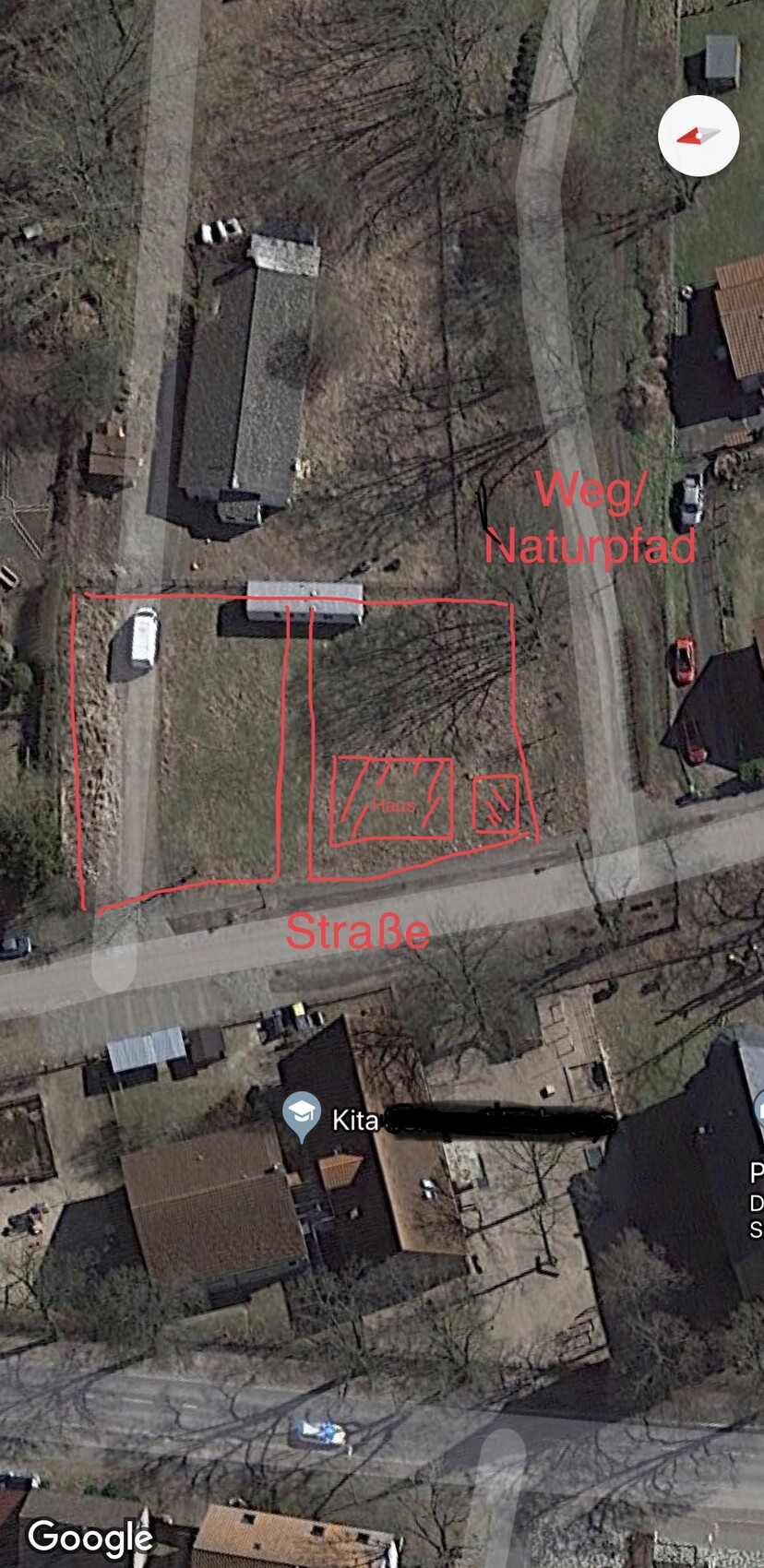

Unfortunately, I can’t identify your Google site plan. Is the plan oriented to north, or is the small compass in the top right corner relevant? To which street do you have to orient the eaves now? Is there currently a road running through the plot to your left, or will it be removed?
Attached is a brief explanation. The eaves must face the street. North should be to the left. The driveway through the left plot will be removed; instead, there will be a new one between the plots.
kaho674 schrieb:
I didn’t even know you could build a 55° roof pitch until now. That looks really awful:
Has anyone actually seen this in real life?
Yes, we have a street here where only houses like that stand. We won’t go up to 55°, we’ll stay at 45°.
