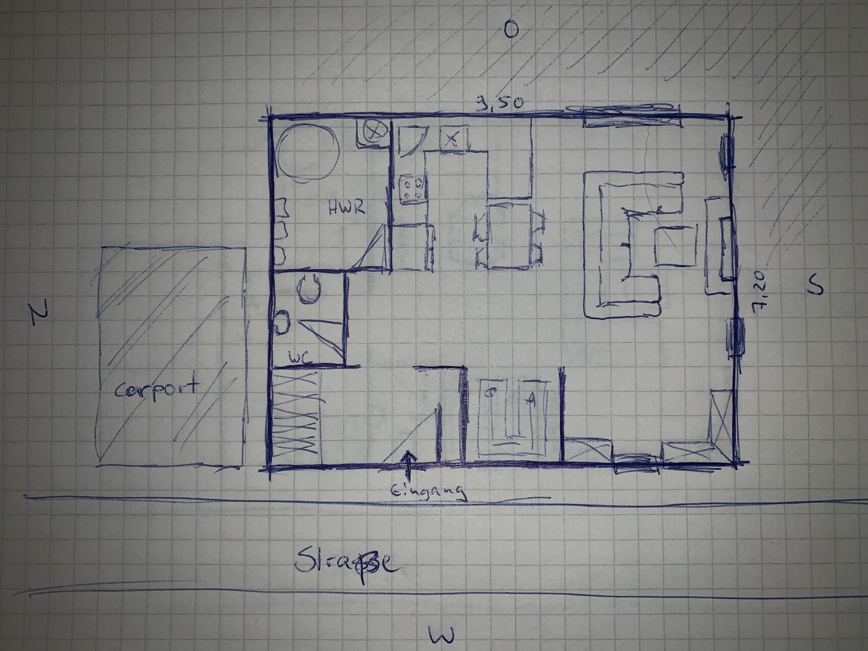

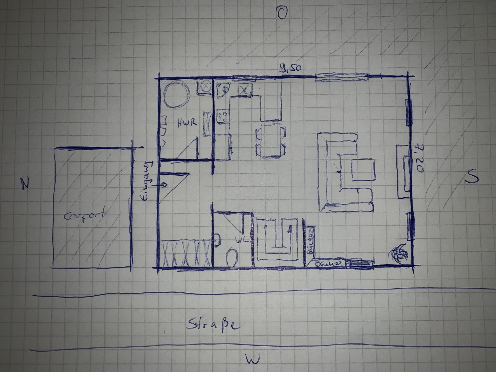

Reluctance23 Feb 2019 22:28ypg schrieb:
And then I wonder why the knee wall of 1.20 meters (4 feet) is rated so negatively, when there was also a wish for a bungalow.I’m slowly getting used to it.
In that respect, I would try to fully utilize the maximum footprint of the house, (...)I’m not sure if I understand this correctly. As it currently looks, we have about 68 square meters (730 square feet) available on the ground floor and less on the upper floor if we only consider the living area. It’s calculated according to net living area (basically the floor area – which together adds up to 135 square meters (1450 square feet)). It doesn’t matter if the upper floor (and therefore the total) has less living space. Making the ground floor generally bigger and having a smaller upper “structure” won’t be possible, as it would not comply with the usual local building style.
The carport in the front north corner, which results in an entrance facing the street; the southeast side (terrace/garden side) with kitchen and living room; then a library in the west corner. Staircase roughly centered on the street side. Save costs on dormers and statics, place the load-bearing wall in the middle as a grid for the rooms. Simple double windows, but more of them. Possibly open the gable in the attic opposite the stairs and use the walls there as shelves.I tried to roughly sketch that out – but I’m not sure if I got it right. Ultimately, the entrance on the street side gives me trouble – I can’t arrange it properly without having the sofa almost right next to the TV, etc. I feel it would be easier to divide if the entrance was on the gable end. But that might look odd from outside and possibly not fit structurally... better let the architect figure that out.
or regarding whether the mentioned ground floor layout in its “original dimensions” would be correct, thinking of a new attic layout to go with it.To be honest, I don’t fully understand the overall dimensions of the mentioned ground floor layout (11 x 8.25 meters (36 x 27 feet)) – I’m too much of a layperson (is that just the gross floor area?). But if I take the square meters of each room, at least on the ground floor it comes to about the size we have available. I tried to roughly replicate that in the drawings, with a slightly different furniture arrangement... and distributed according to the house orientation.
R
Reluctance23 Feb 2019 22:49Reluctance schrieb:
I tried to roughly draw it out by the way: I was too tired for the upper floor (first floor/second storey) now
