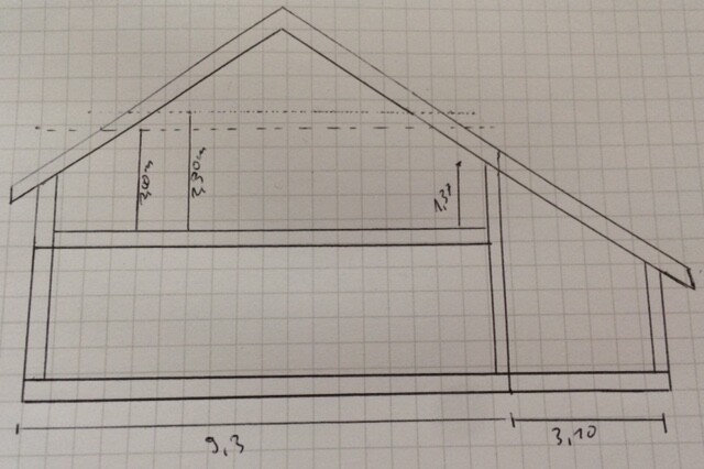

-Markus-
8 Jul 2015 18:30
So, we already have a roof everywhere 🙂
The pitch is 35° (35°).
Markus

-Markus-
8 Jul 2015 18:42
Hmm. Looking closely at the picture again, I noticed something else.
I measure a height of 2.2m (7 ft 3 in) on the exterior wall (south).
That means the shower wall in the guest bathroom is also only 2.2m (7 ft 3 in) high (under the sloped ceiling). Is that enough?
