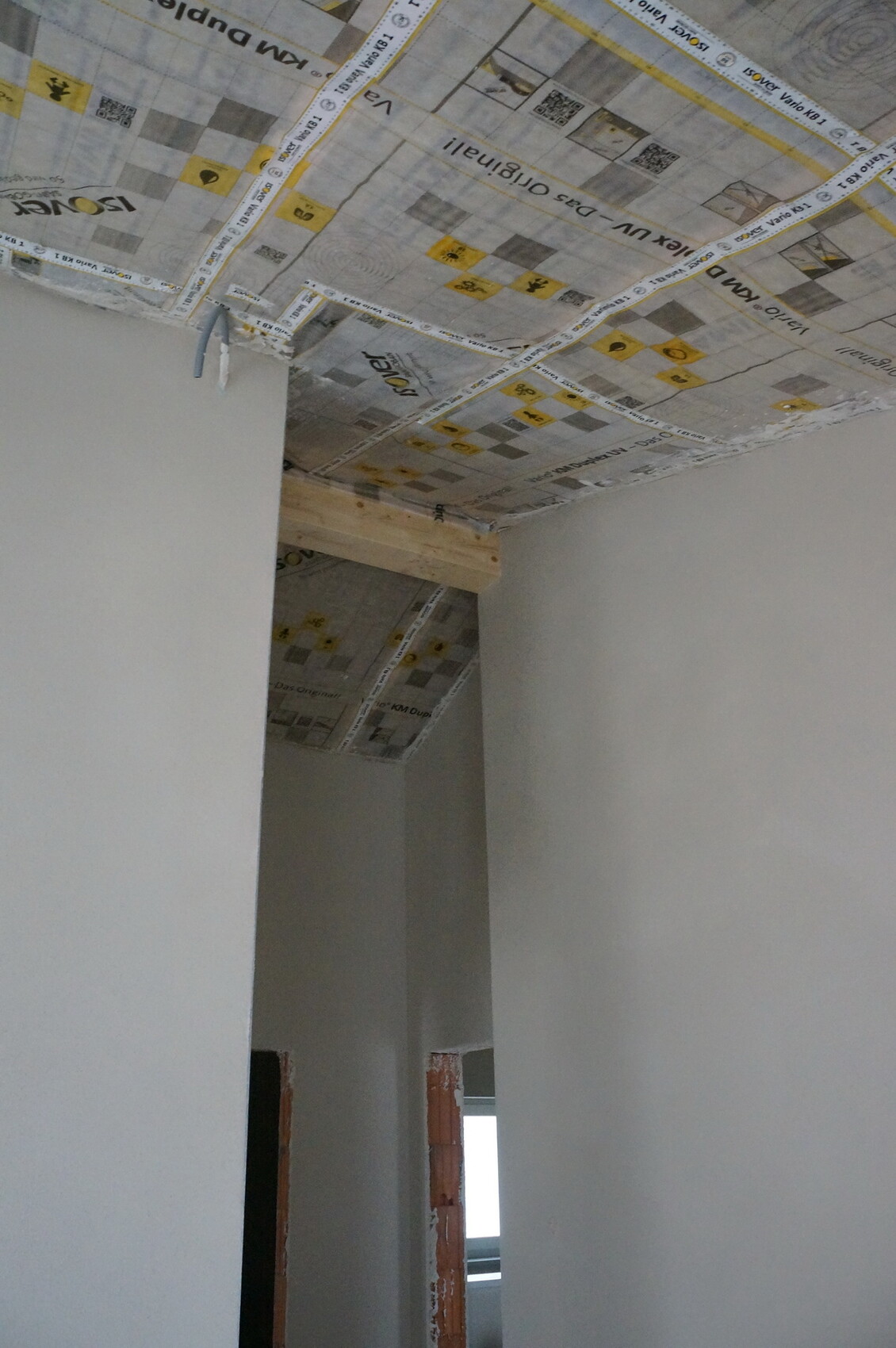

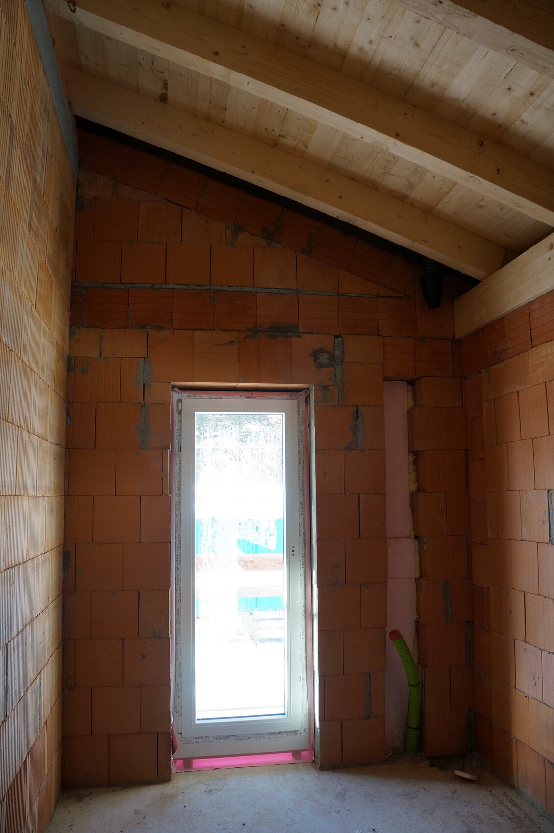

This topic is also interesting to me. Does anyone here perhaps have more pictures? Unfortunately, not much comes up in the Google search.We’re not finished yet, but maybe these photos help give an idea (2x shell construction, 1x base plaster...)?
We’ll be installing drywall panels as the ceiling underneath the insulation... Most of the beams will remain visible. We don’t have any roof windows.
