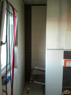

Jaydee20 Jan 2014 14:18
We have arranged the layout similar to your version 1, but with a full-height wall:
Small bathroom layout with bathtub on the left, sink in the middle, toilet on the right, and door.
This is how it currently looks from the door:
Small bathroom under construction with window on the left, black tile border, and installed bathroom furniture.
There definitely needs to be lighting installed in the shower area where the full-height wall is, otherwise it will be too dark.

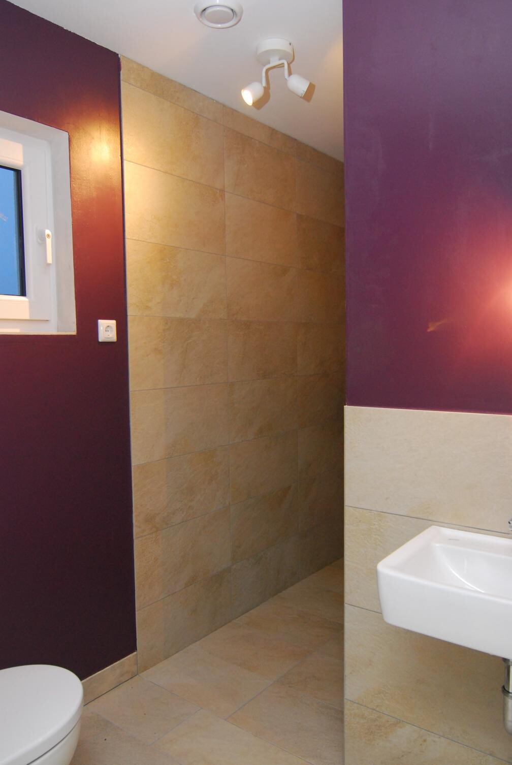

20 Jan 2014 14:39
We went with something similar to option 2. The advantage is that you end up standing at the basin more often for handwashing, where you get nice natural daylight from the side, so you don’t have to turn on the light switch. With option 1, you lose that natural light.
Bathroom with purple wall, beige tiles, washbasin, toilet, and window on the left.
Masipulami20 Jan 2014 14:49
In option 2, I’m not sure if the passage between the sink and the toilet is wide enough. We would have between 75 and 80 cm (30 and 31.5 inches) available. Is that sufficient?
Thank you for the photos and your feedback.
@ypg:
How much space do you have between the sink and the toilet?
