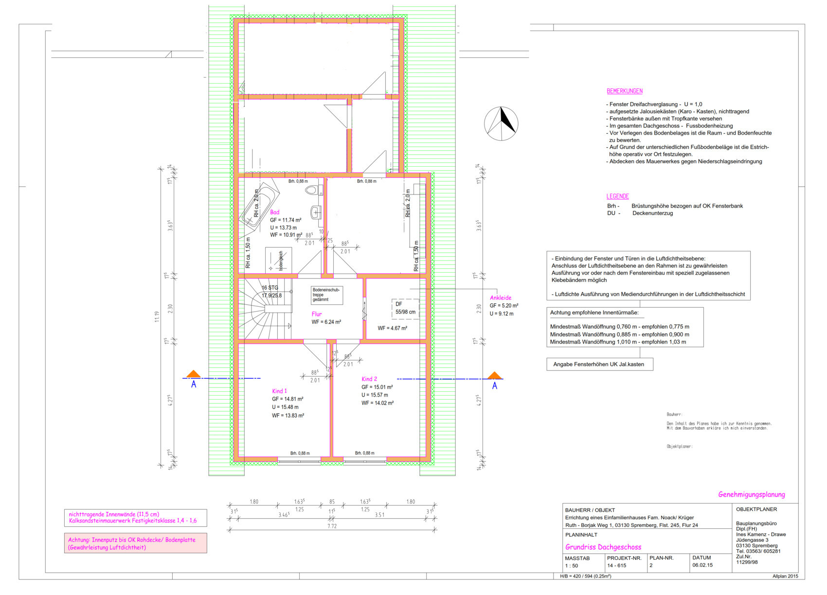

Hello dear forum community,
I’ve had a somewhat crazy idea running through my mind for the past few days.
We built our house in 2015 and everything is basically perfect for us. However, in 2017 we had another child and are now five in total. Unfortunately, our house does not include three children’s bedrooms, so our two daughters share a room. That might work for now, while they are still toddlers, but I fear that this will not always be a good solution...
Since my dad and I have done a lot of the work on our house ourselves, we have been trying to come up with some ideas. Unfortunately, the floor plan does not offer many options, and realistically, only an extension is possible.
However, the building plan assigns a specific building plot. This plot is already fully utilized in all directions. Except to the north, where we still have about 8 meters (26 feet) of space... Currently, this area is occupied by our garage plus carport.
I could imagine an extension above the carport/garage here.
For that, the existing ceiling made of rafters and battens would need to be replaced with a concrete ceiling (a precast concrete slab?). I would like to keep the carport and garage as they are, and just build on top of them. The garage stands 1 meter (3 feet) outside the building plot, so I wouldn’t be able to build over the entire area. Still, this would create a floor space of about 8 x 6 meters (26 x 20 feet). Then everyone would have their space in the house...
My questions on this are:
1. Would something like this be possible, or would such a construction project be prohibited due to building regulations / planning permission?
2. Could the garage/carport be retained, or would this also be impossible due to structural engineering reasons? The concrete ceiling would need to be supported on the existing brick garage.
3. The bathroom and a new room would only have lighting through (large) roof windows—is this allowed?
4. What would be sensible or feasible regarding heating? The utility room is located right next to the carport... we have a gas boiler installed.
5. The current “parents’” bedroom would then become a large hallway—what could be done with that space?
I know there are no 100% certain answers here... I’m mostly interested in the key issues I might have missed that could turn this into a bad idea...

Yosan schrieb:
Why would you want to extend the hallway all the way to the back in the extension, instead of having the rear room span the full width?True... I completely overlooked that in my enthusiastic "mock-up"... it definitely makes much more sense... thanks!

Would it be possible to remove the wall between the bedroom and the dressing room so that an L-shaped space is created, which could then be divided in some way? Or arranged so that at least the children's beds are separate. So that two children share this room, but each has their own individual area. The parents would then need to be in another room.
