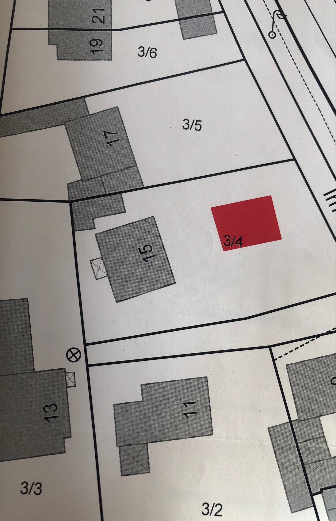

Here are the current plans (we own the approximately 800 sqm (8,600 sq ft) plot 15; the red building does not exist):

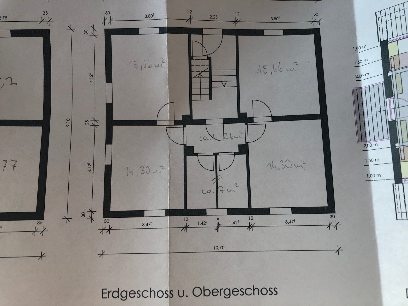

Your floor plans are incomplete, and the small site plan excerpt is not really useful. The floor plans also do not appear to date from the original year of construction (more likely from the attic conversion?). The floor plans seem to confirm a suspicion of @Tolentino (it seems that a mix of old and new brick sizes was used). Why you insist on the idea of turning the granny flat into a semi-detached house, only the gods know. The extension potential of the current house does not support this concept in any case. Possibly, an upper-level entrance could be created for the “upper floor & attic” unit. What about the shed / barn / laundry room—what role should this secondary building play in the future, and could it possibly be removed?

Yes, you are right, the situation has changed in that the first floor is no longer occupied, and our grandmother (who lives on the ground floor) is open to all suggestions and options. Since she still lives in the house, it does make a difference for her whether she would have to move out permanently (in case of demolition and new construction) or only for 1–2 months. The energy standard the house (possibly a duplex) can be brought up to during a major renovation or conversion also matters. It should be a low-energy house; a passive house standard is probably impossible with the renovation. Basically, our first step is to clarify which floor plans are possible with the existing house. Then we would compare the costs of new construction versus renovation, as well as the energy standards, and so on. If a duplex is not possible from the start, or if a house with separate ground floors (an entrance through the first floor is not an option) is excluded, then a renovation won’t be considered anyway. For KfW funding, renovation would of course be ideal.

Unfortunately, there are no additional plans of the house apart from those already uploaded 🙂 Or which plan exactly do you mean?
