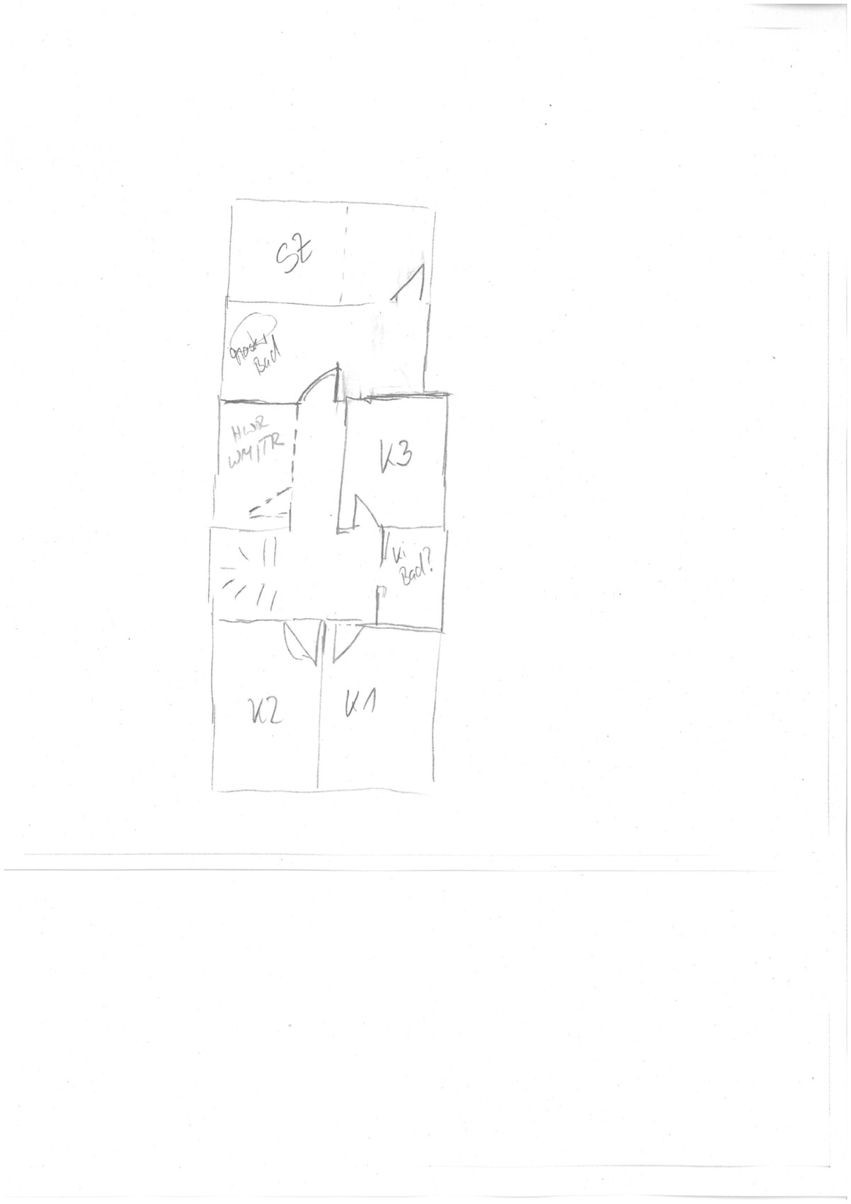

With a sufficient budget, I would relocate the bathroom: place the master bedroom above the garage/carport with an ensuite bathroom, and possibly add a walk-in closet if desired.
The plumbing connections should work since there is a utility room and a toilet on the ground floor.
The current bathroom could become a passageway, where a utility room can be created since the connections are already there. This could be a "hallway utility room," meaning the washer and dryer don’t necessarily have to be hidden behind a wall. Then, the current bedroom could become the third child’s room. Possibly, the small storage room could be converted into a children’s bathroom (although I’m not sure how the drainage would work there).
But as mentioned: the existing bathroom would need to be completely removed — the question is whether the budget allows for that.
If so, it would be a practical solution. (Dashed lines in the utility room show where I wouldn’t add a wall.)
Oops, I forgot the sloping roof, so the door from the master bathroom to the new bedroom would have to be centered (but then the hallway to the front wouldn’t have worked either, right?).
