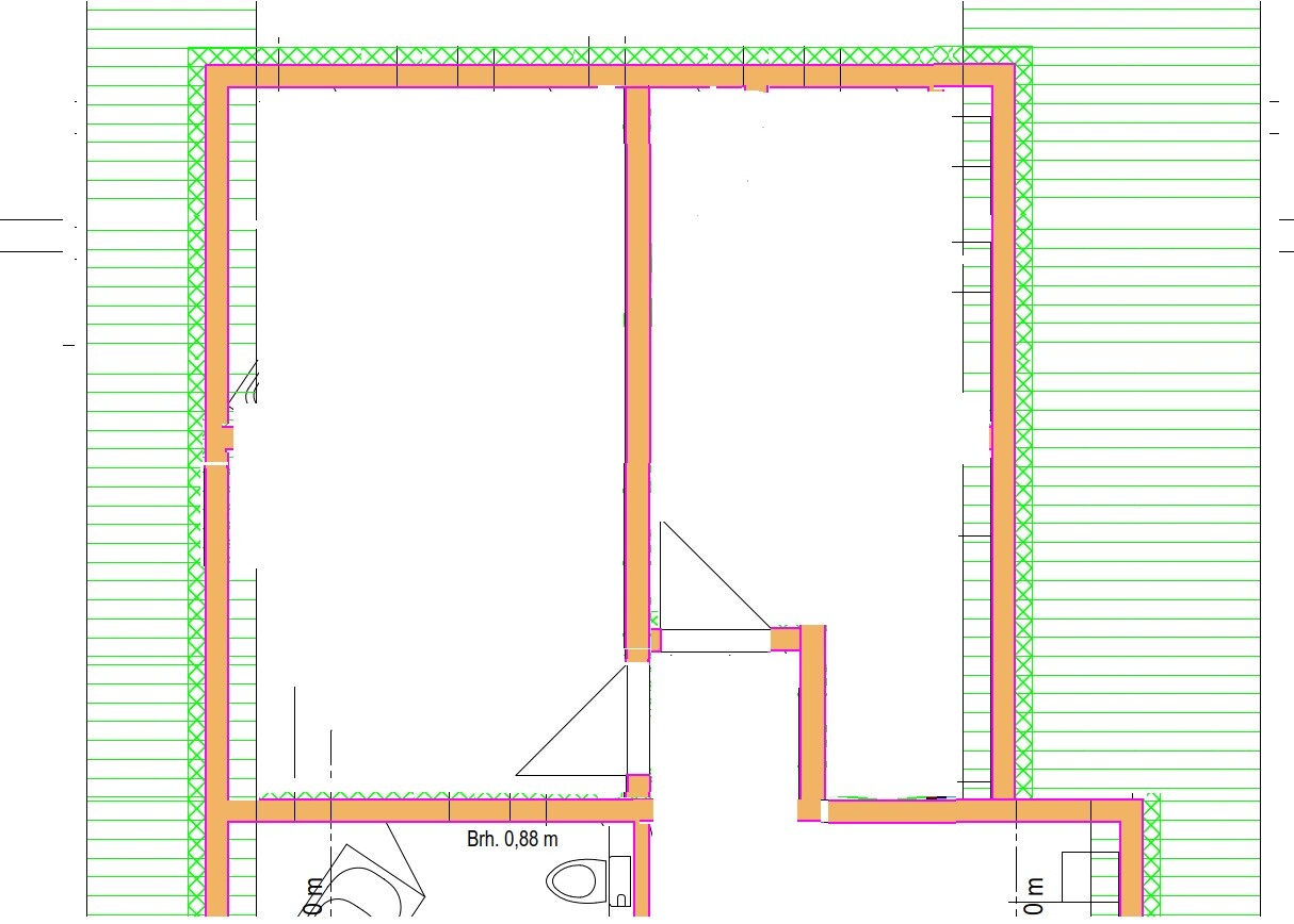

Matthew039 Jan 2019 13:58@halmi’s question makes sense, please show the ground floor plan 😉 Also, to answer properly, it would be helpful to know: How old are the other two children? There might be alternative solutions.

In my personal opinion, what you gain through the extension is not remotely proportional to the price.They are 2.4 and 10 years old...
Before you invest a lot of money: would it be an option to temporarily separate the living area to use as a bedroom for yourselves?
This is certainly not an ideal solution, but ideally, the two younger children would share one room for another four or five years, and the oldest could get their own space at 18 or 19. That way, this arrangement would only last a few years.
Alternatively, if technically feasible, I would also consider enlarging the storage room on the upper floor at the expense of the existing children’s rooms. Then the rooms wouldn’t be 15 m² (160 sq ft) anymore, but at least all rooms would be located in the same section of the house.
