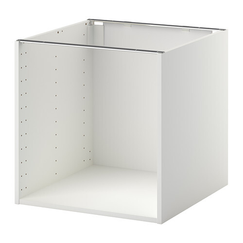

IKEA-Experte24 Feb 2015 14:36because it’s you.
Metod:
Product dimensions
Depth without hanging rail: 59.0 cm (23 inches)
Depth including hanging rail: 60.0 cm (24 inches)
Width: 60.0 cm (24 inches)
System depth: 60.0 cm (24 inches)
Height: 60.0 cm (24 inches)
Product dimensions
Width: 59.7 cm (24 inches)
System height: 80.0 cm (31 inches)
System width: 60.0 cm (24 inches)
Height: 79.7 cm (31 inches)
Thickness: 1.6 cm (0.6 inches)
You could also simply measure your Faktum cabinets.

westkueste24 Feb 2015 14:51What exactly are you trying to prove with this?
You are actually showing that your claim—that the Metod cabinets are wider than the FAKTUM units—is incorrect.
Metod cabinets are not wider than, for example, 600mm (24 inches), nor are FAKTUM units narrower than the nominal dimension, such as 600mm (24 inches).
I don’t understand why you are referring to a foreign Ikea website for this.
That won’t help you, since it only lists measurements like 600mm (24 inches), not smaller, as you suggested.
Maybe you should try measuring them yourself?

Herr rossi24 Feb 2015 18:20Hello West Coast,
IKEA expert is right. You should measure your Faktum cabinets. The easiest way is to get a cheap Metod door and just try it out. The old Faktum series, to be exact, for a 60 cm (24 inch) cabinet was actually only 598 mm (23.5 inches) wide. This dimension resulted from the bottom width of 561.5 mm (22.1 inches) plus 2 times the side panel thickness of 18 mm (0.7 inches). The tolerances for both width and length must not be 0.5 mm (0.02 inches) less or 0.2 mm (0.008 inches) more. It’s the same with the Metod series; the bottom is now exactly 564 mm (22.2 inches) wide. IKEA is very precise about this, no matter in which country the carcasses are produced. The guidelines are the same for every manufacturer. If you are wondering how I know this: I work at a company that manufactures Metod and Pax, and we are regularly trained to keep the quality as high as possible. IKEA sets this standard very high for all, whether abroad or like us in Germany.
Regards, Herr rossi
