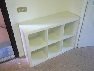

most photos showing the interior of these shelves are still of the Expedit model and not yet of the Kallax.
The picture illustrates this quite well (but there are also people who build hamster cage holders from these shelves and then cut ventilation openings into the panels).
The linked image clearly shows the frame construction made of chipboard strips, which is quite similar in the Kallax as well (see also the comments in the link above).
If you position the shelf supports so that the holes go into the chipboard frame, it should work – however, the holes would then be quite close to the edges and the support pegs would be clearly visible. How wide the frame is remains another question...
