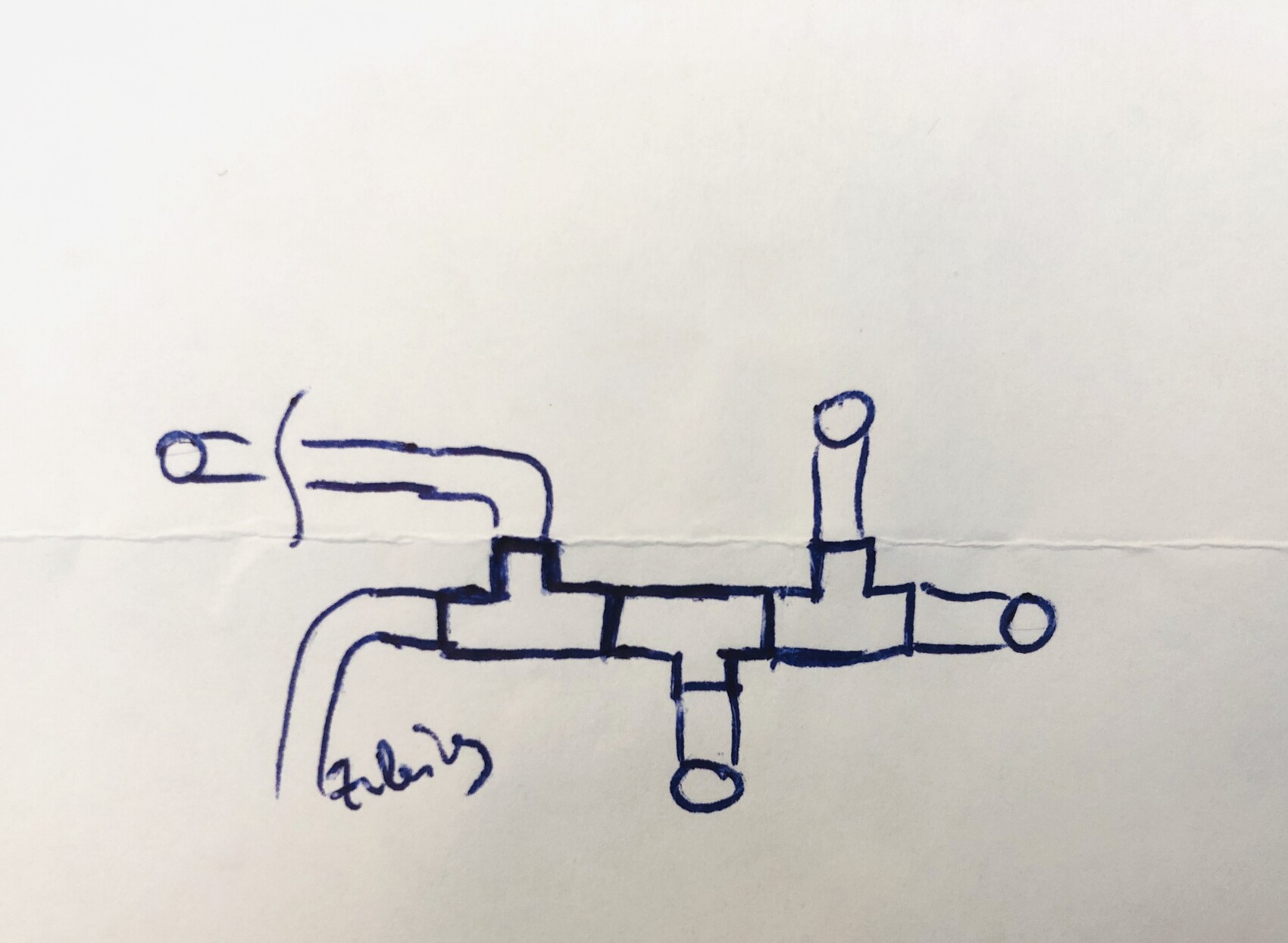

Hi everyone,
What is the best way to connect these four rotors to the supply line? Three T-joints in series?
I have also run a second supply line to the right rotor (for the socket located next to the rotor). If the water pressure for the four rotors is too low, I could potentially use this line for the fourth rotor.
Fittings do not fit directly in a row (unless they are threaded). Therefore, there must always be a section of pipe in between. How are you connecting the sprinkler housings? Do you have the complete connection kits? There are several options. If you have the kits with T-pieces, proceed as planned. At the end, use an end cap.
