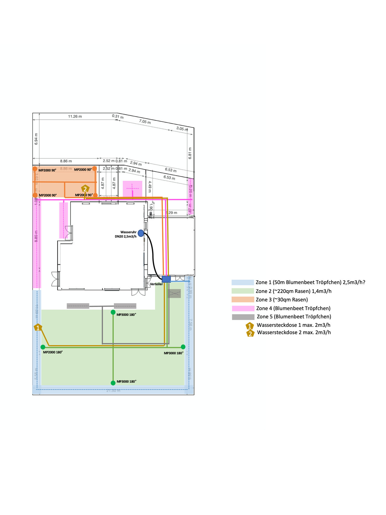

Hi everyone, I’ve been giving some serious thought to where I’m going to dig my trenches. It looks like a lot of work, especially since the front area is already fully compacted, so using a trenching machine is the only way to go.
There will be 7 channels = 8-way manifold.
Any suggestions? Otherwise, this will be ordered and carried out as planned.

Green: Don’t you water the corner at the top right? I don’t see any sprinklers there.
Water cans could be connected in one line. This saves a valve or keeps one as a spare.
Pink: Please create a separate irrigation zone for the tree. It has a very different water requirement compared to the flower beds.
Blue: Given the length, I would rather split it into two 25-meter (82 feet) sections. Supply each from the left and right sides. Either keep it as one zone or better, assign each to a separate zone. I also suspect different water needs here.
Since you are running almost everything in a main trench, you will need a mini excavator anyway. With 4 lines and fittings, the trenches are too narrow and/or not deep enough for a standard trenching machine.
No irrigation on the left side of the house after all? If you’re still undecided, I would lay a pipe and cap it. That way, if you ever need it, you won’t have to dig up your garden.

Different water requirements can be managed to some extent by using various drippers with different flow rates. I have decided not to control the water supply with valves at all and instead keep the water running constantly. I think this is more practical.
A quick question: Are you sure you want to run the pipe all the way to the middle at the top left in Zone 3 and then back to the right? You could include the sprinkler at the bottom right on the same line. You planned pressure-regulated risers, didn’t you?
