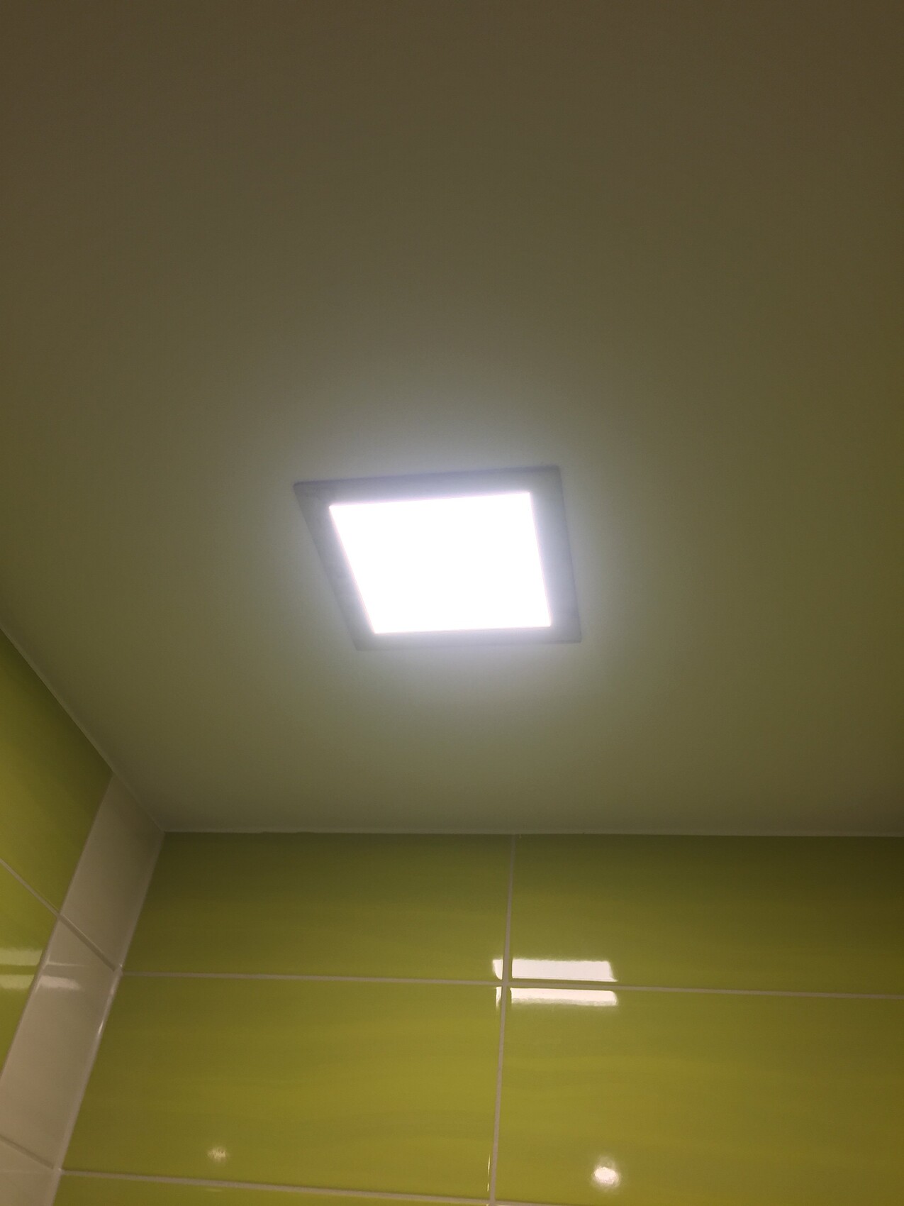

- In the hallway and in each shower, I would install light panels; they look elegant and provide subtle, bright lighting. (The picture below is from our shower.)

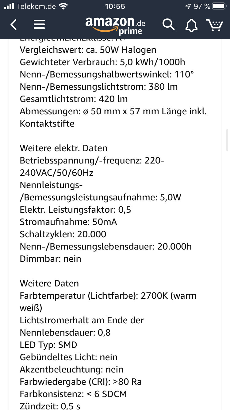

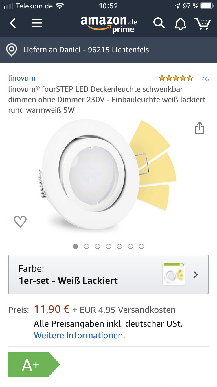

- We are considering the following light fixtures (see attachments). They can be dimmed with a simple switch... what do you think?
