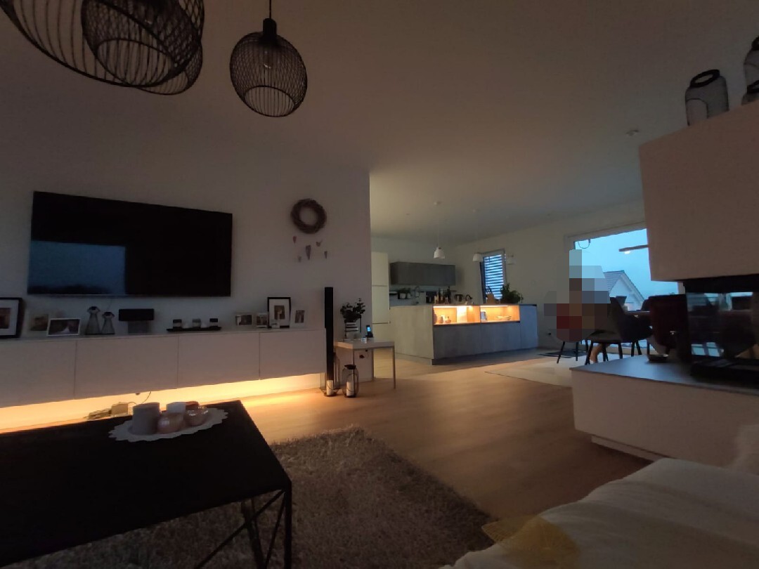

Wugler197816 Aug 2019 12:11ivenh0 schrieb:
[ATTACH alt="Living room lighting – sufficient lighting – 341051-1.jpg"]37530[/ATTACH]If the fireplace were on the other side, you might think this was our living room.
The indirect lighting under the TV looks amazing. I’ll suggest this to my wife tonight. It also fits with the recommendation (lighting for TV) from YPG.
ivenh0 schrieb:
[ATTACH alt="Living room lighting adequate-341051-1.jpg"]37530[/ATTACH]From the size, layout, and access points, this looks like an ideal open-plan living area. (Of course, also the decor and furniture, although I find the decoration under the TV a bit too much.)
Could you please send me the floor plan? You know I do design work, so having a realistic comparison is always helpful.
