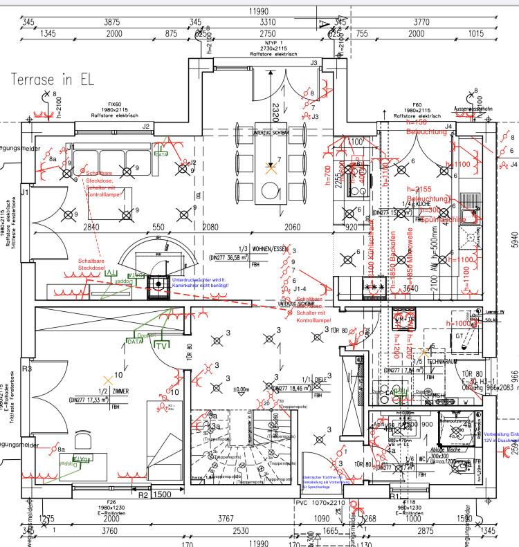

I am looking for an electrician who could review my electrical plan. I am especially concerned about the layout and the number of (LED) spotlights, which are causing me sleepless nights.
I am open to any suggestions......
Thank you and best regards

I am aware of the costs involved......
michert
26 Dec 2019 13:41
Spotlights are ideal when good lighting with minimal shadowing is needed. They are perfect for kitchens, bathrooms, and possibly hallways. In living and bedrooms, spotlights can feel quite impersonal. It is better to use wall lamps and floor lamps for accent lighting in these areas.

Jake12345
26 Dec 2019 13:48
Thank you, I will discuss this again with my wife. The suggestion has come up quite often now. Maybe no recessed lights in the living room and bedroom after all...

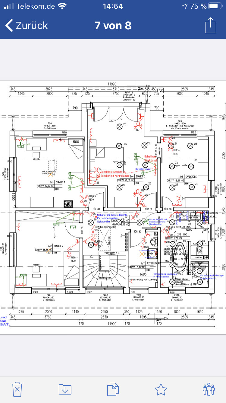

I revised it and removed some lighting spots. I would appreciate your honest opinion once again... I don't want an operating room myself, but unfortunately, I have no experience.
Thank you!

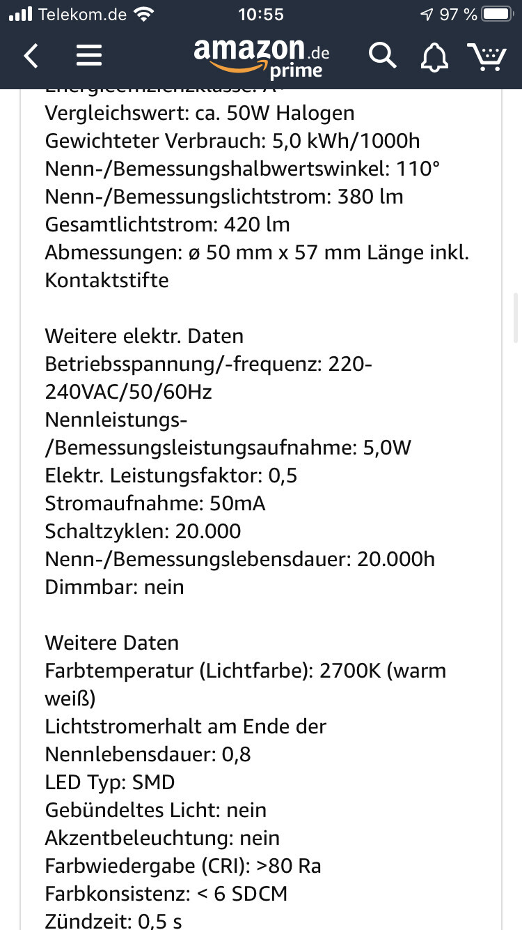

Does this mean you advise against having two spots, or are you suggesting installing two spots in the shower? We’re still undecided on that...
We wanted to use the following spots (dimmable via a simple switch)...
Round white LED ceiling light (recessed fixture) with yellow segments in the background
LED lamp: 2700K, 50W equivalent, 20,000h, SMD, 380 lm, 50mA
kbt09
26 Dec 2019 18:57
But you should also read what we wrote, for example about the spotlights in the kitchen, which are supposed to illuminate the countertop and not the back of the person working.
And then the question ... why are there so many spotlights in the bedroom? What kind of living situation do you imagine there?
