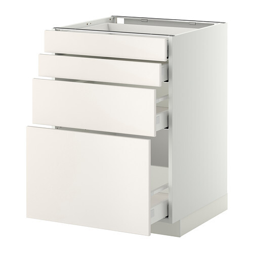

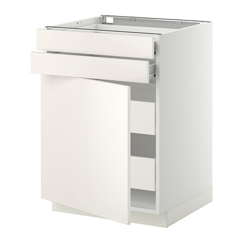

Where is the space supposed to come from then? It might only work with Förvara. If you look at
White kitchen base cabinet with two drawers on top and an open door revealing three shelves inside.
and
White freestanding drawer cabinet with four pull-out drawers.
it appears that the top edge of the frame in FÖRVARA is slightly lower than in Maximera.

That is a good idea! Frame height according to the brochure 7.8cm (3.1 inches) vs. 7cm (2.8 inches).

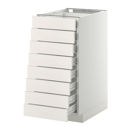

9 Jul 2014 16:33
If the fronts align properly on the cabinet with 8 drawers, they should also fit correctly with the oven positioned between them.
White drawer cabinet with many shallow drawers, freestanding
