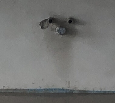

Shouldn't the drain pipe (kitchen) actually be located under the screed? This metal clamp also protrudes quite a bit! How am I supposed to install my tiles properly with this?

The general contractor did not want a kitchen layout; we simply indicated during the planning process where everything should be placed. Nothing was changed afterward.

Someone overlooked this! It’s true that the kitchen cabinets might cover it, but it looks terrible.
Who made the mistake? Was there not enough screed applied, or is it insulation, or was the pipe cut incorrectly?
I would try to negotiate a discount with the screed installer if it will be hidden behind the kitchen.
The screed installer is not to blame; this is a planning error.
Best regards, Schuch
More likely an installation error! The support bracket and the water pipes should be embedded in the plaster, not placed on top of it. Why would anyone do that? Marvin, it feels like you keep messing things up with every trade.

So, unless the client requested something afterwards, I suspect that the connection was simply forgotten and was hastily installed just before the screed. TE, was it like that already at the time of the rough installation, that is, before plastering and underfloor heating?
