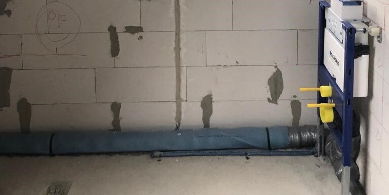

Unfortunately, I can’t find a better photo at the moment, but you can see a little. This is how it looks at a colleague’s place upstairs in the bathroom. Since the pipe diameter is too large and the slope needs to be maintained, about 4–5cm (1.5–2 inches) was chiselled away from the ceiling.
Blaue Rohrleitung liegt am Boden; rechts eine Wandvorrichtung mit zwei gelben Griffen.
