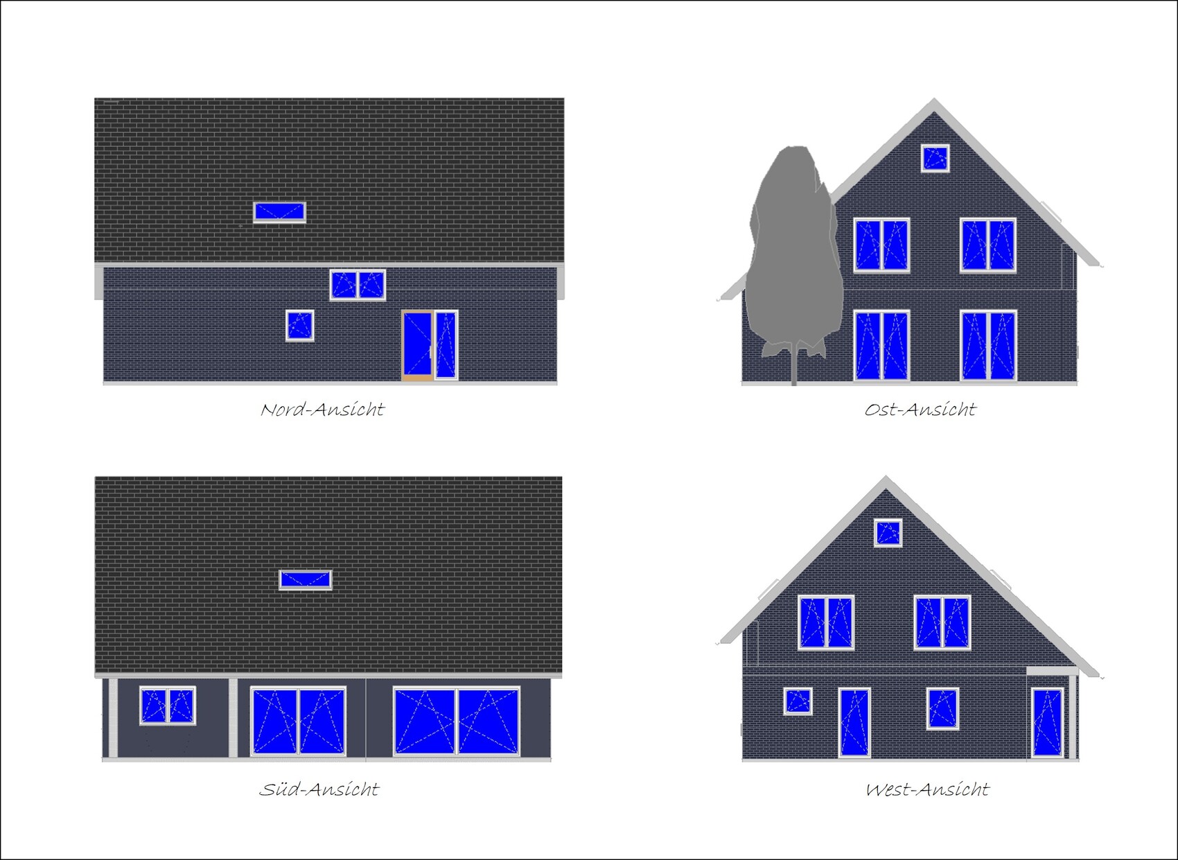

We are planning to build a single-family house this year – two adults and two children.
The requirement is a single-story design.
We have chosen a traditional pitched roof because it is more compact and durable (compared to a townhouse with a flat roof extension or similar). However, we planned a high knee wall to minimize the impact of the sloping walls.
Here is the latest draft from our architect!
The guest WC and kitchen still need a window/light strip facing west.
On the upper floor, roof windows are missing in the stairwell, bathroom, and storage room.
The floor area measurements on the upper floor are still gross floor areas, as the exact height of the knee wall has not yet been determined.
I’m looking forward to your feedback! Does the house seem coherent, and are there any possible no-go’s that might have been overlooked?

White clinker bricks are simply disproportionately more expensive. We prefer dark gray, and if it were just about the appearance, we would also plaster a white strip about 5m (16 feet) wide on the gable ends. Unfortunately, this will probably not be allowed and also contradicts the principle of a low-maintenance facade.
We have now decided on gray-blue facing bricks and anthracite-colored roof tiles. On the planner's advice, the roof tiles are not glossy/glazed. The window frames will be white.
The house has grown by about 15 cm (6 inches) in length (north-south) to enlarge the utility room and the hallway in the bedroom.
Then there was the question of the roof overhang. We have now chosen 80 cm (31 inches) on the north side and 50 cm (20 inches) on the south side, because otherwise the height of the roof overhang/covering over the kitchen would have been only 2.25 m (7 ft 5 in). It is still quite low, but the roof geometry is apparently determined by the projecting living room and the single-story structure. The planner advised against a "kink" in the roof at the spot of the kitchen covering.
We are not yet 100% satisfied with the elevations; some fine-tuning is still needed – but according to the planner, this is still possible after submitting the building permit/planning permission application.

Another topic is the bathroom layout on the upper floor. The bathroom is 2.45 m (8 ft) wide and 3.3 m (11 ft) long. The door is on the short side. The planner suggested placing the bathtub and shower on one side and the toilet and wash basin on the other. We have, however, been thinking about a corner bathtub and have searched a lot online – but unfortunately found few layouts that really fit. Does anyone here happen to have any ideas?

@kaho has already said everything about the tiles, and I can only confirm these statements. I would add that with wood-look tiles, a seemingly good wood appearance is only achieved at sizes over 70cm (27.5 inches). Below that size, the imitation effect is noticeable, which might also be intentional.
Regarding the bathroom: corner bathtubs reduce space in narrow bathrooms and are therefore not very suitable. The neat standard layout always looks elegant.
