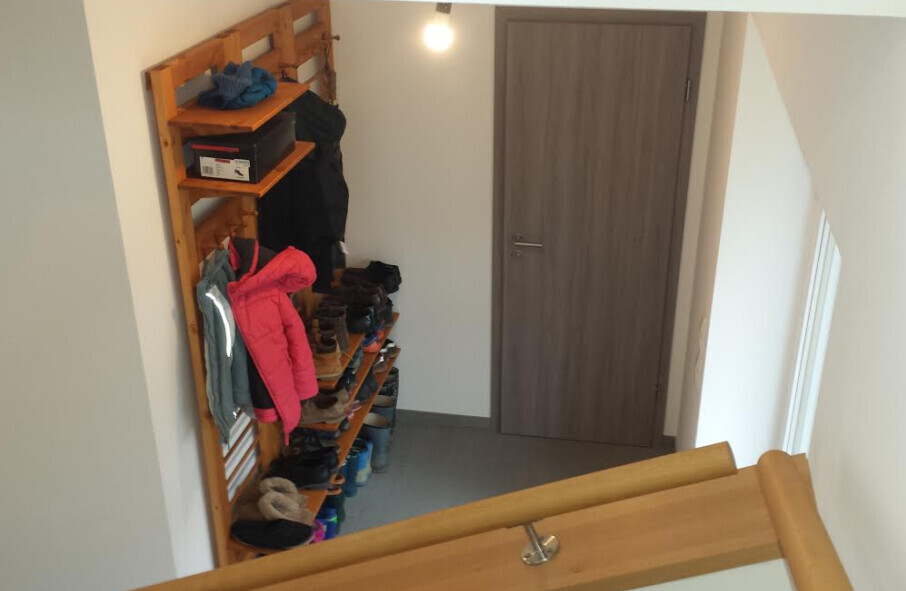

How do you handle dirt in the hallway? You don’t have an enclosed entryway or anything similar for shoes and such.
We actually think that an enclosed entryway is necessary; otherwise, the kids will track dirt all through the house.
On the other hand, the staircase wouldn’t look the same with that kind of layout…
I find the staircase very nice, but it needs to be properly positioned.
One question about that:
The children take off their shoes at the cloakroom in the front – but depending on the mud situation, it can get dirty there as well – though I think you also have that in the entrance area. So, really bringing dirt inside doesn’t happen, and since you only pass through the entrance area when going outside (except for the restroom), it’s not an issue at all.
Unfortunately, this doesn’t help with muddy feet and kids who prefer to use the wall instead of the handrail.
Mike1234567890130 Jun 2016 23:15Yes, that’s true, but I don’t want to have to look at the dirt in winter and the 80 pairs of shoes the kids scatter all over the place whenever I go to the office, bathroom, or bed.
So, I’m actually leaning towards having an entrance hall... but the staircase really does have its appeal. Hmm, difficult choice.
