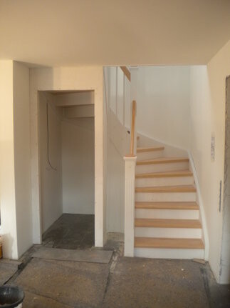

The planner also recommended a closed staircase, mainly for noise control, with the additional benefit of creating storage space. Our only concern is that this might make the hallway too dark — is this worry unjustified?

I would always include a storage room under the stairs. You wouldn’t believe how much can fit in there. It also won’t be too dark for you, as plenty of light comes in through the side panel, and there is enough light from above as well.

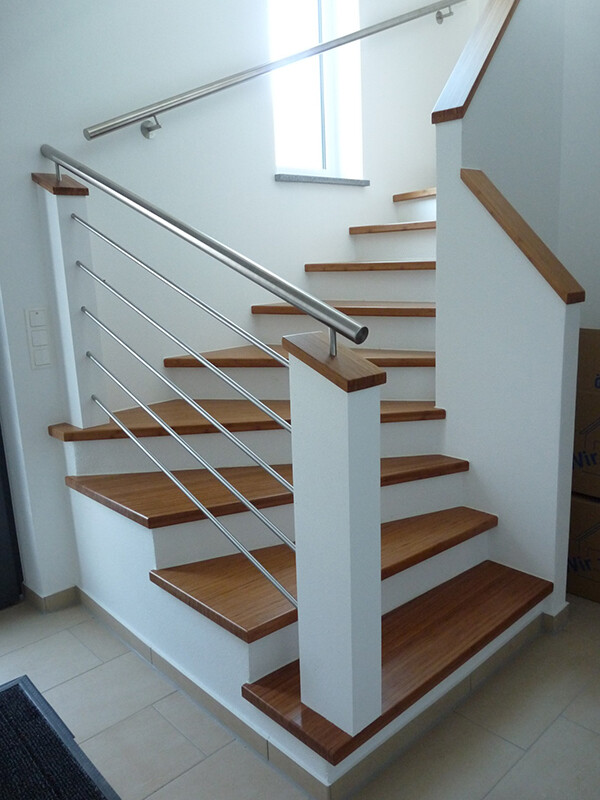

Last night, we came up with a charming solution for the staircase – a mix of the two pictures (one representing the storage room, the other the entrance area).
