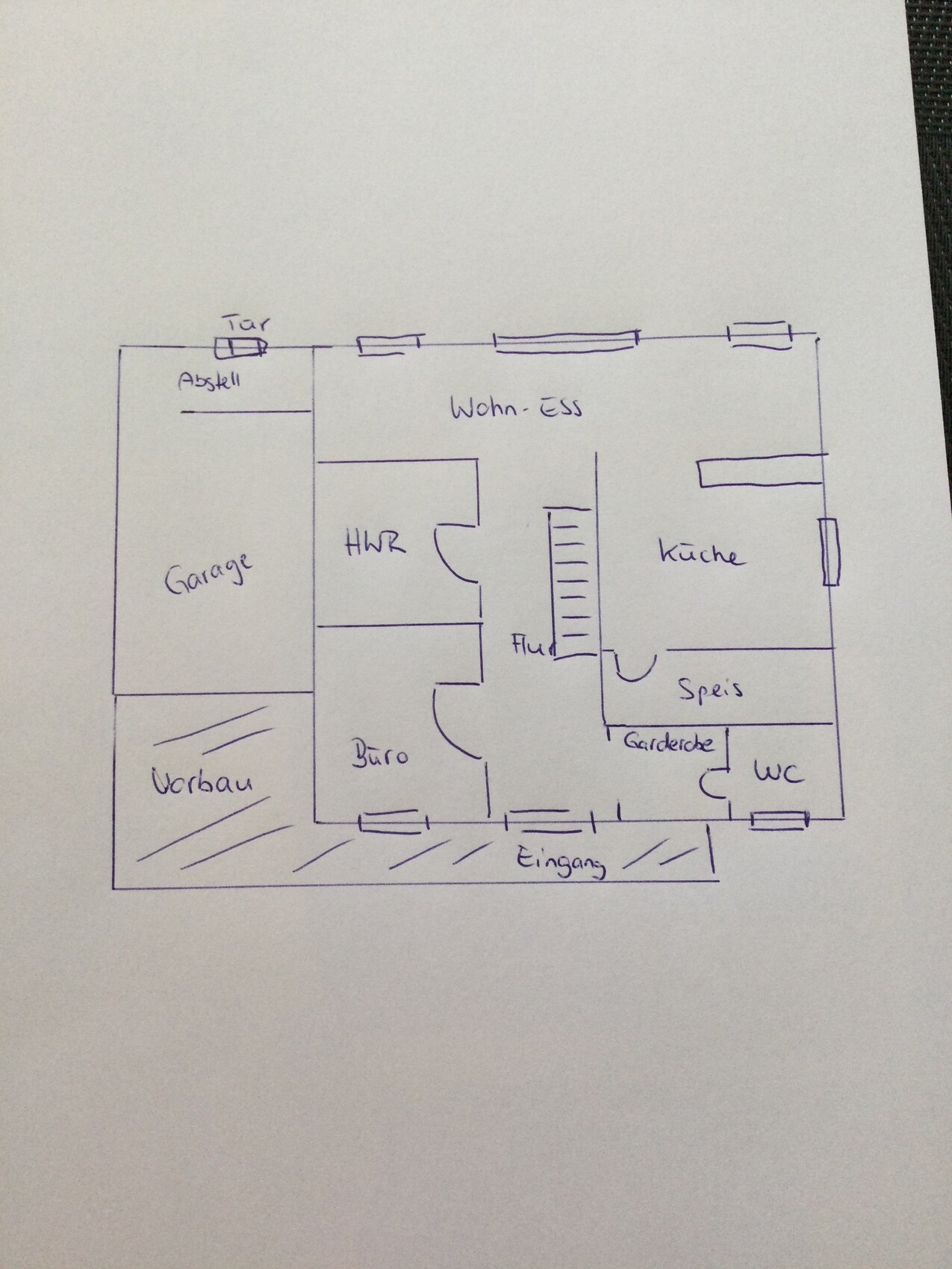

Your utility room can’t be located like that; otherwise, you could place a window at the back on the ground floor. Here, almost everything is underground and dark because it’s the basement!
Chloe83
7 Jun 2021 14:37
@driver55
To help with understanding, I made a rough hand-drawn sketch. The other windows are also not final. The extension is intended to be a kind of canopy so that the second car can at least be partially parked underneath.
Floor plan of a house: entrance, living-dining area, kitchen, pantry, office, utility room, cloakroom, WC, garage.
