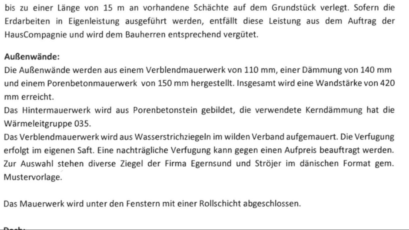

A quick question, if I may.
Is this type of wall construction acceptable?
It’s from the building description provided by my contractor.
Textdokument zu Aussenwaenden Daemmung und Gebaeudehuelle mit Bauvorschriften

So the insulation values look good. Intuitively, 150mm (6 inches) feels thin, but if the structural engineering allows it... Just keep it in mind if drilling ever needs to be done.
Honestly, the pointing bothers me. They offer clinker bricks but don’t complete the work properly.

@blaupuma : You need to decide for yourself whether it is acceptable.
The additional insulation is cost-effective but also has disadvantages (fire safety, harmful substances, etc.).
