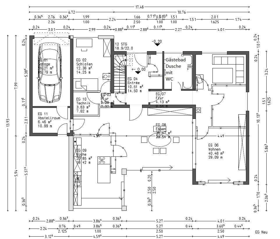

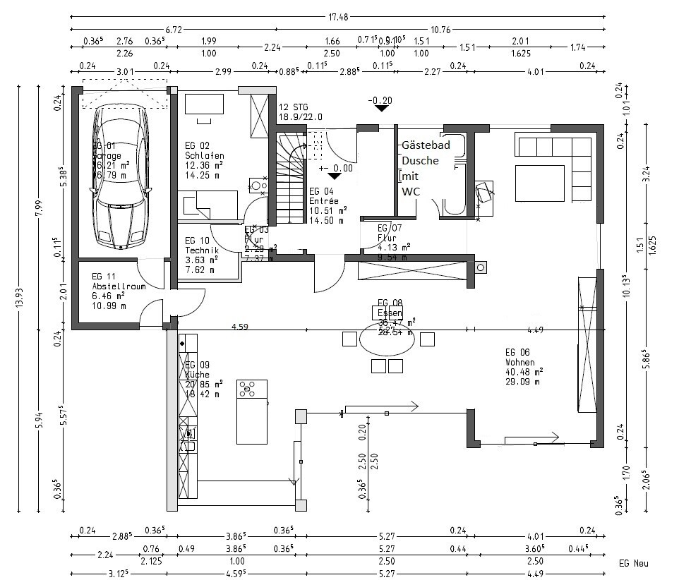

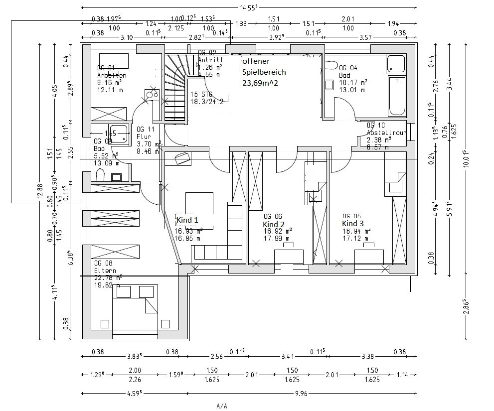

I agree with the general impression – very confusing.
Is the upper area intended to be sold as a separate residential unit for subsidy purposes?
There is a very tight bottleneck between the kitchen island and the exterior wall; you would never be able to walk comfortably there...
The 60cm (24 inches) space in front of both sides of the walk-in closet is also completely pointless. Try placing two cardboard pieces the size of closet doors on the floor with 60cm (24 inches) between them – it just feels cramped.
That odd pipe under the ground floor bathroom is also surprisingly useless.
My favorite, though, is the doorless bathroom on the ground floor – at least it will stay clean...
By the way, it fits with the garage – please remember to drive the car in before the fourth wall is built.

Addendum: A parapet height of 77cm (30 inches) right next to the toilet, in the dressing room, and behind the washing machine doesn't exactly suggest careful planning. What type of glass will be used there?
And I definitely wouldn’t want a 77cm (30 inches) parapet height right next to the bed either. Keyword: "neighborhood conversations."
The longer I look at the plan, the less thoughtful it seems...

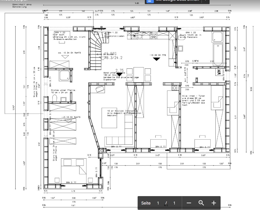

Janinashome19 Aug 2022 21:11Hello everyone,
we are working on realizing our dream home and would appreciate any input.
We are renovating a bungalow built in 1961 with an added upper floor constructed as a timber frame. On the ground floor, we have removed several walls to create a large open space for the kitchen, living, and dining areas. Our dream is to have views of and direct access to the garden from all living spaces. We also want direct access to the terrace from the kitchen. Our architect has advised us well in this regard. However, it’s possible we overlooked something during the planning. Sometimes you can’t see the forest for the trees 🙂 Please forgive me if there are any unclear points; I am, of course, open to making changes or additions. This is my first post in a forum. But if not now, when? With that said, thank you in advance for the feedback 😉

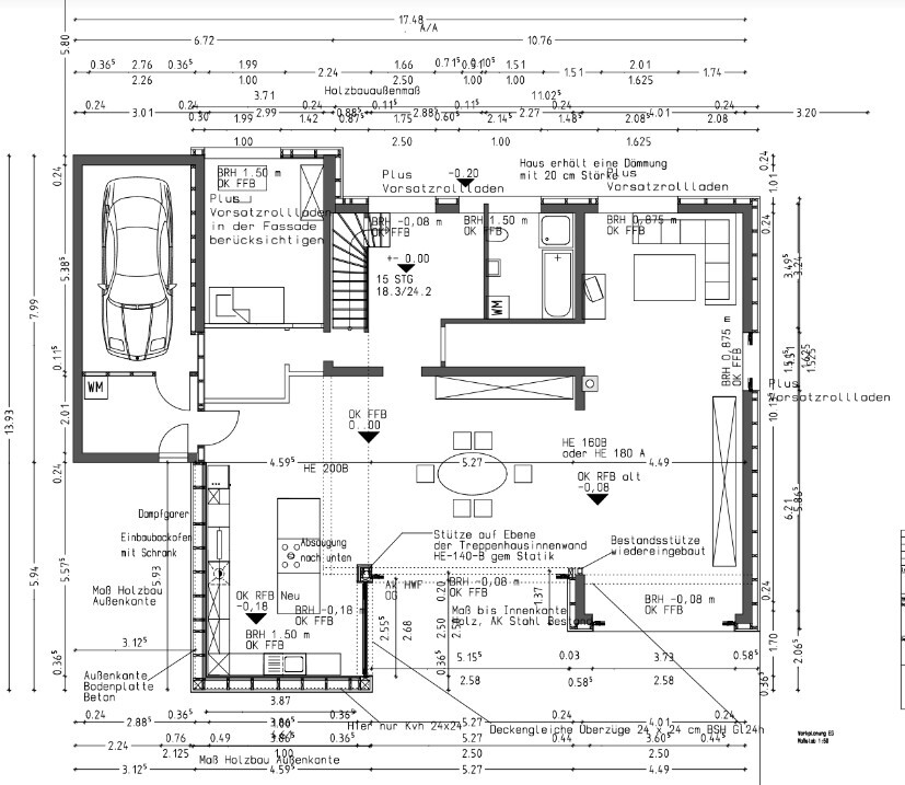

Here are some updated floor plans, hopefully less confusing. Regarding the garage: it used to be a garage but is now used as a “basement room.”

Myrna_Loy19 Aug 2022 21:28This is even more confusing. Are there multiple levels stacked on top of each other? And why are there different versions in the construction execution?
I work a lot with architects and have seen many floor plans, but I have never encountered such a confusing mess.
And the garage is officially being repurposed? Does the floor area ratio and plot ratio actually comply with the surroundings and the zoning plan?
