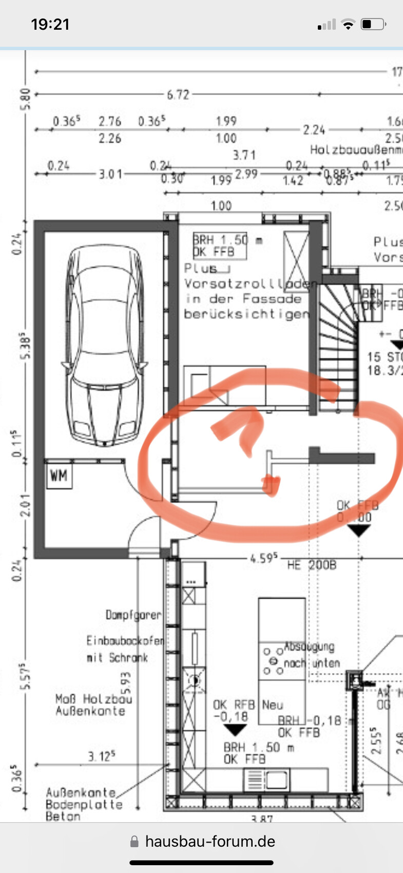

Myrna_Loy19 Aug 2022 17:28I don’t understand the plan. Three full bathrooms, two of which have bathtubs? Two living rooms but only two children’s bedrooms on the upper floor for three kids? One children’s bedroom? Downstairs? And what is that huge room on the upper floor next to the stairs? Is it about 300 sqm (3,230 sq ft)? It seems extremely oversized with a lot of circulation space. And somehow, the rooms are large.

I don’t understand the plan. I didn’t immediately recognize the main entrance either. 😉When remodeling, the usual practice is:
- Existing walls marked in black,
- Walls to be built: red,
- Walls to be demolished: yellow,
otherwise it remains a guessing game, for example, why there is such a strange hallway between the bathroom and the open living area on the ground floor.
K a t j a schrieb:
I didn’t recognize the front door right away either. 😉I’m still looking. 🙂 Is that supposed to be the 70cm (28 inches) access for the steam oven? 🙄 😀

Myrna_Loy19 Aug 2022 19:25Is this a guest room or the driver’s room?
