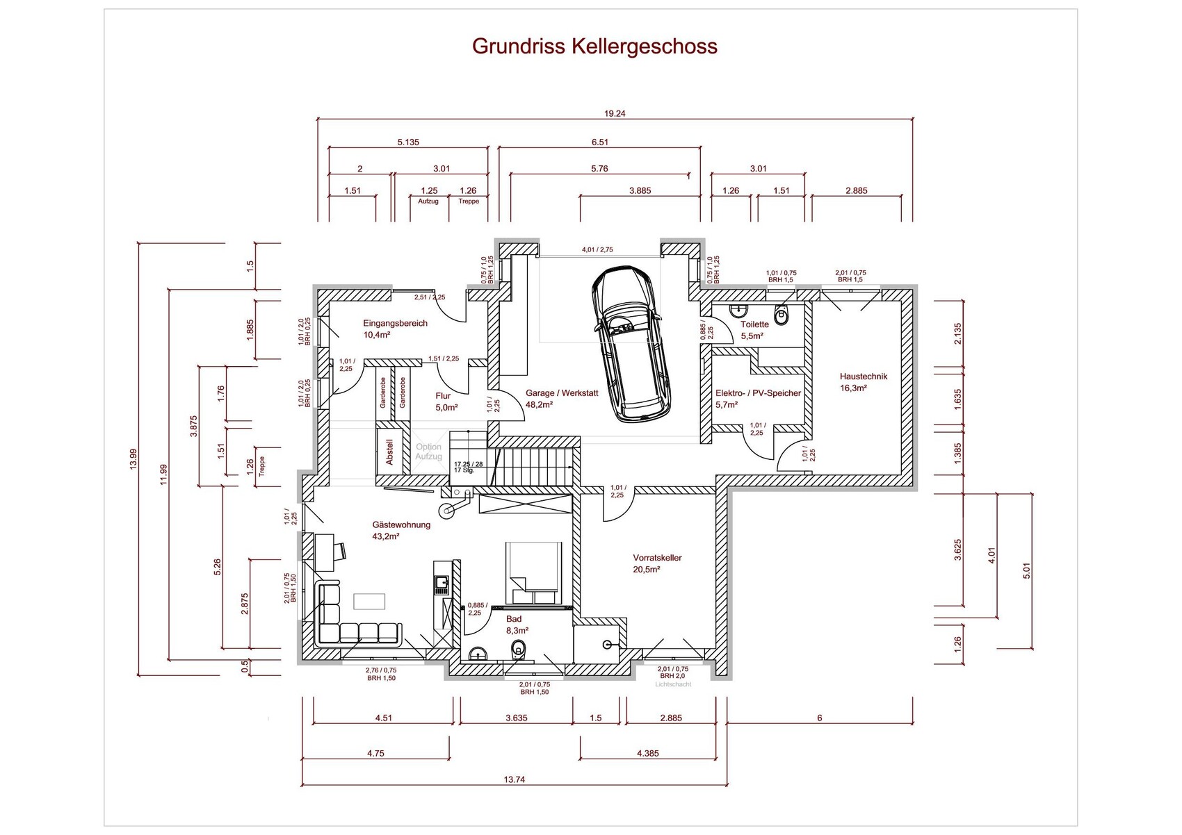

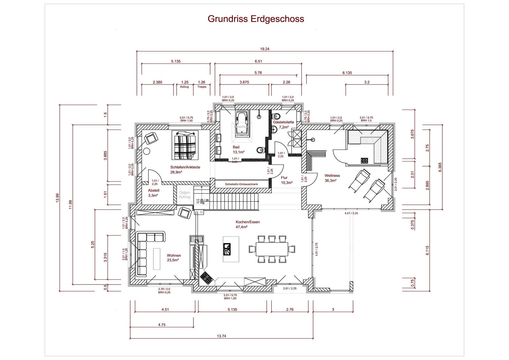

Here are the dimensioned floor plans for your information. I hope everything is easy to read.
You can look at it either way, but I just don’t trust those devices. That’s why there is a locked electrical room in the basement, and the photovoltaic battery storage is securely enclosed as well. 😉
kbt09 schrieb:
I’m missing measurements on the floor plan. The wardrobe area doesn’t look deep enough.
The rise and run of the staircase are not clear.
Who exactly is supposed to use the guest apartment? Really just occasional guests or someone more permanent? I’ve just added the dimensions; the wardrobes are currently planned with a depth of 50cm (20 inches) each. We could move the partition wall 10cm (4 inches) to the left to gain a bit more depth.
I hope the measurements are now readable. The staircase has a rise of 17.25cm (6.8 inches) and a run of 28cm (11 inches) with 17 steps.
The guest apartment is intended for family and friends when they visit, possibly later in life for a housekeeper or caregiver. Renting it out as a separate unit is not planned.
hanghaus202324 Nov 2022 14:34The floor plans already look much better. I’m curious to see if the architect can make them a bit more stylish. As they are now, they look like a mix of different styles.
hanghaus202325 Nov 2022 08:41wolko22 schrieb:
Hello hanghaus2023,
which styles do you think we have mixed here?
Or to put it another way, which planning details in the floor plan do you think are stylistically inconsistent?In my opinion, it’s not really the floor plans. It’s more about the overall concept.I wouldn’t design the house like that on the plot. For example, a tiny garage (5 meters wide and a 4-meter door) right in the middle of the house? If possible, I would place the garage on the living level and next to the house with at least 7 m by 7 m (23 ft by 23 ft).
I’m waiting to see the architect’s final result.
