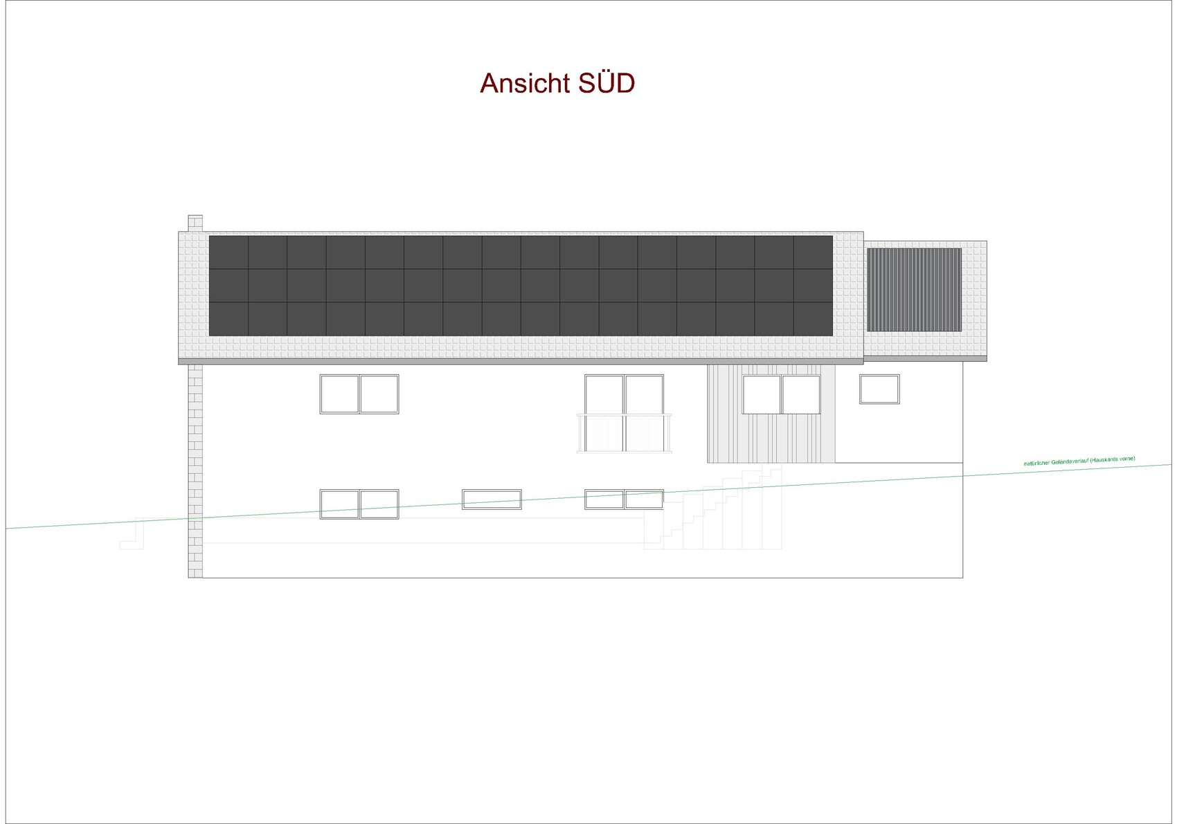

Hello dear forum community,
after quietly reading along for a long time, we have now registered here and want to share our house plans with you.
First of all, we would like to say a big THANK YOU – the information you get here is truly invaluable.
Now a bit about us: we are both around 50, and our two grown children have moved out. Currently, we live in my parents’ house, but we want to realize our own dream of building a house. We are very fortunate to be able to afford the construction without any problems. The building plot belongs to us, and the local building authority has given us a verbal go-ahead so far (there is no zoning plan as it is currently farmland). We only have to contribute proportionally to the development costs, which is fine for us.
Our children and guests enjoy visiting, so we want to set up a guest apartment in the basement. For old age, our design allows us to convert the ground floor barrier-free at any time with minor modifications, including an elevator if needed. In case of emergency, the guest apartment could also be used for a carer, although hopefully this will never be necessary.

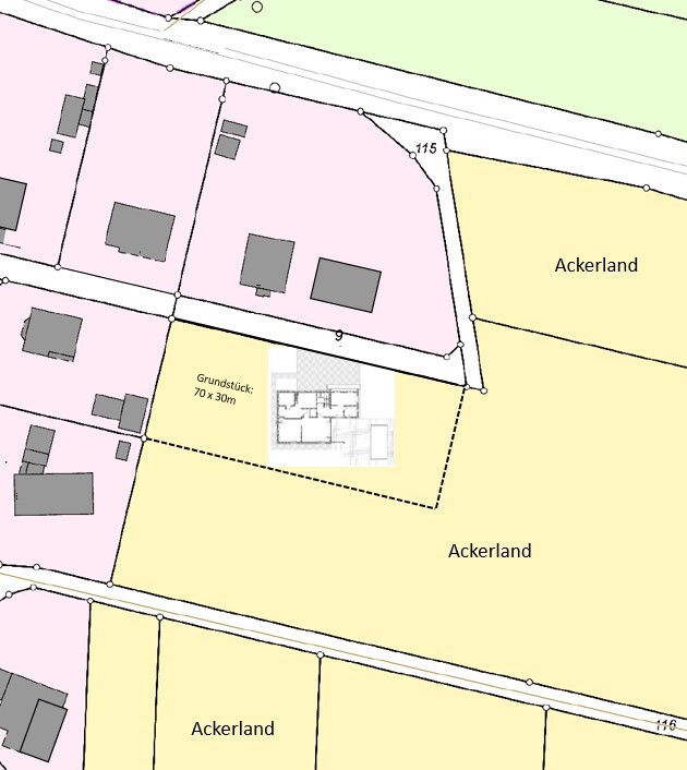

Zoning Plan / Restrictions
Plot size: 2,100m² (0.52 acres)
Slope: Yes, see elevations
Floor area ratio: no zoning plan
Floor space index: no zoning plan
Building envelope, building line and boundary: no zoning plan, we keep at least 6.0m (20 feet) clearance all around
Edge development: No
Number of floors: 1 story, basement
Roof style: hinted “shed roof”
Architectural style: ???
Orientation: North/South
Maximum height / limitations: No specifications
Further requirements: No valid zoning plan, planning permission granted for usual residential construction

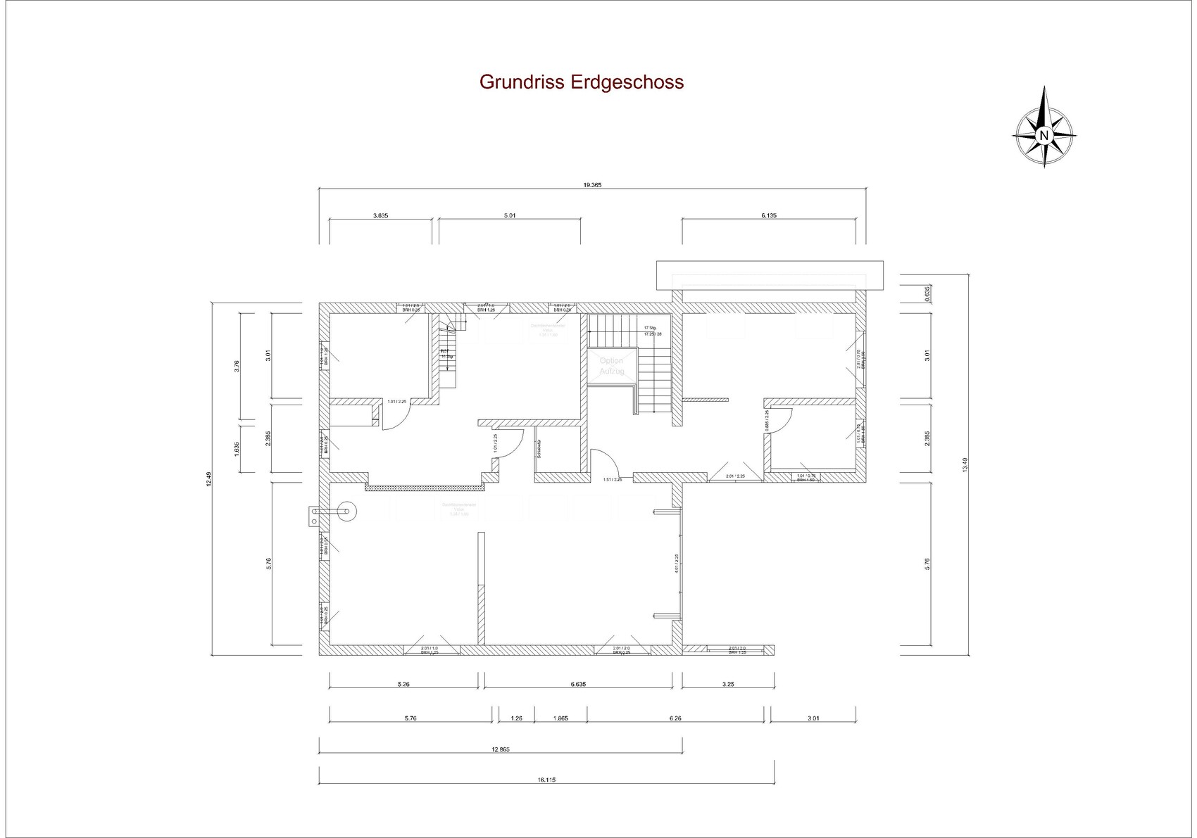

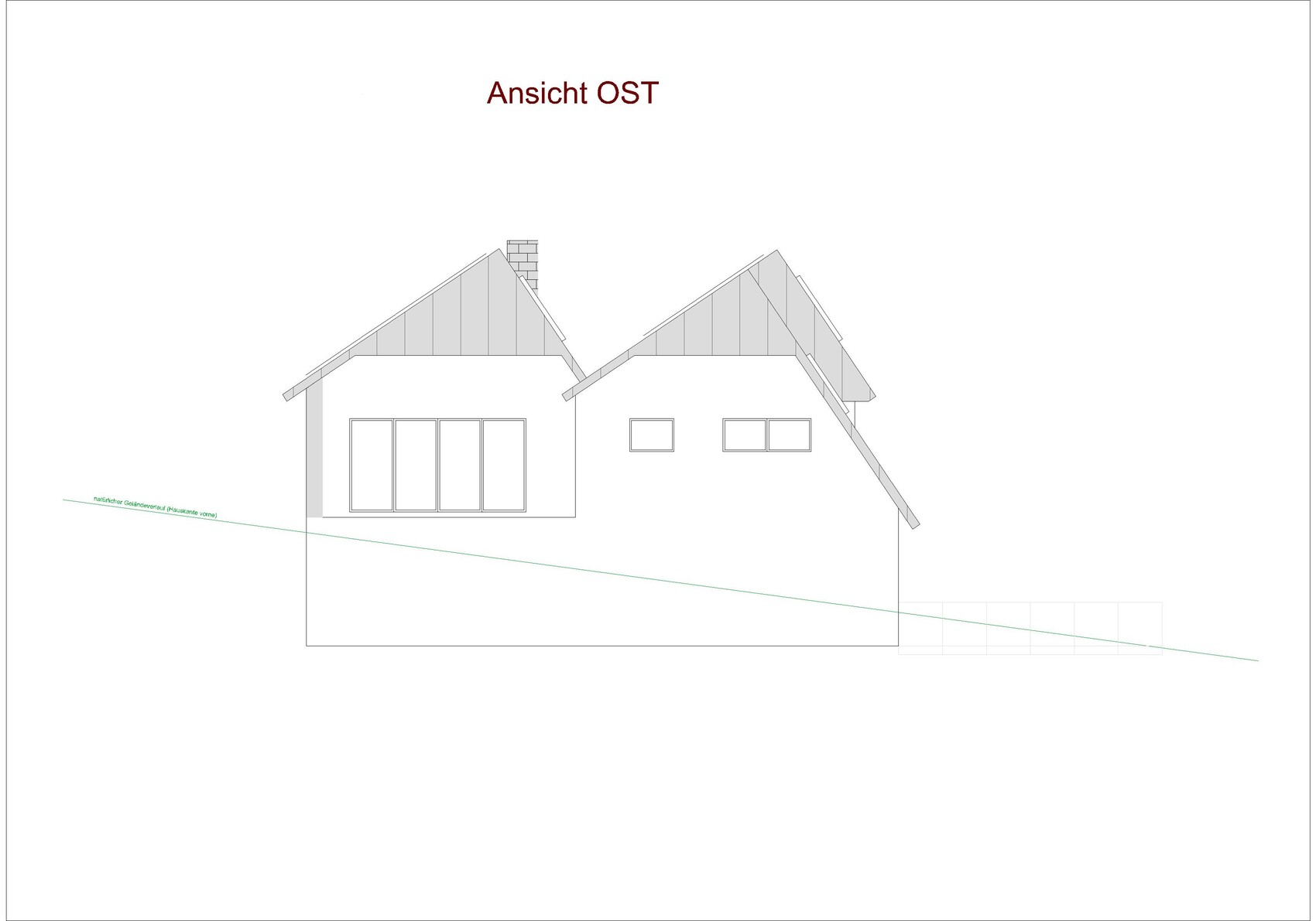

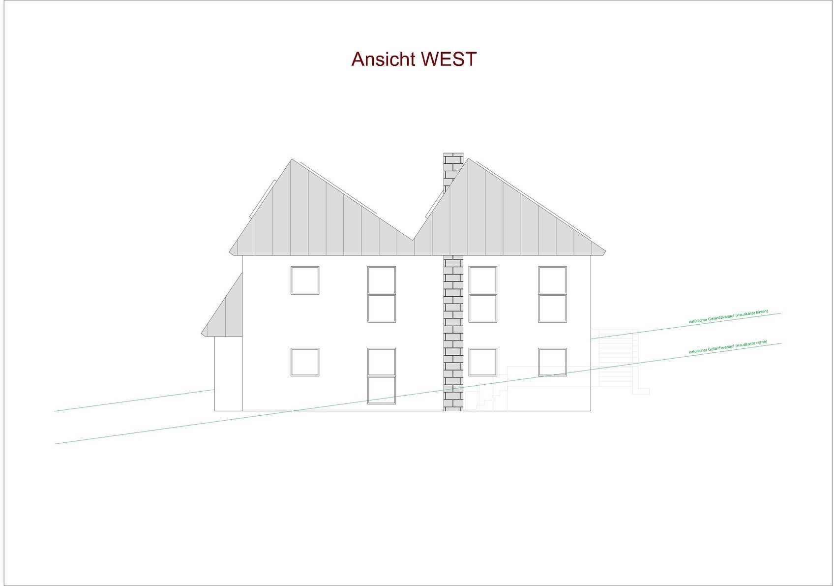

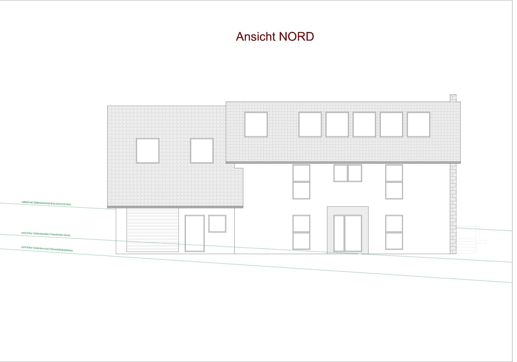

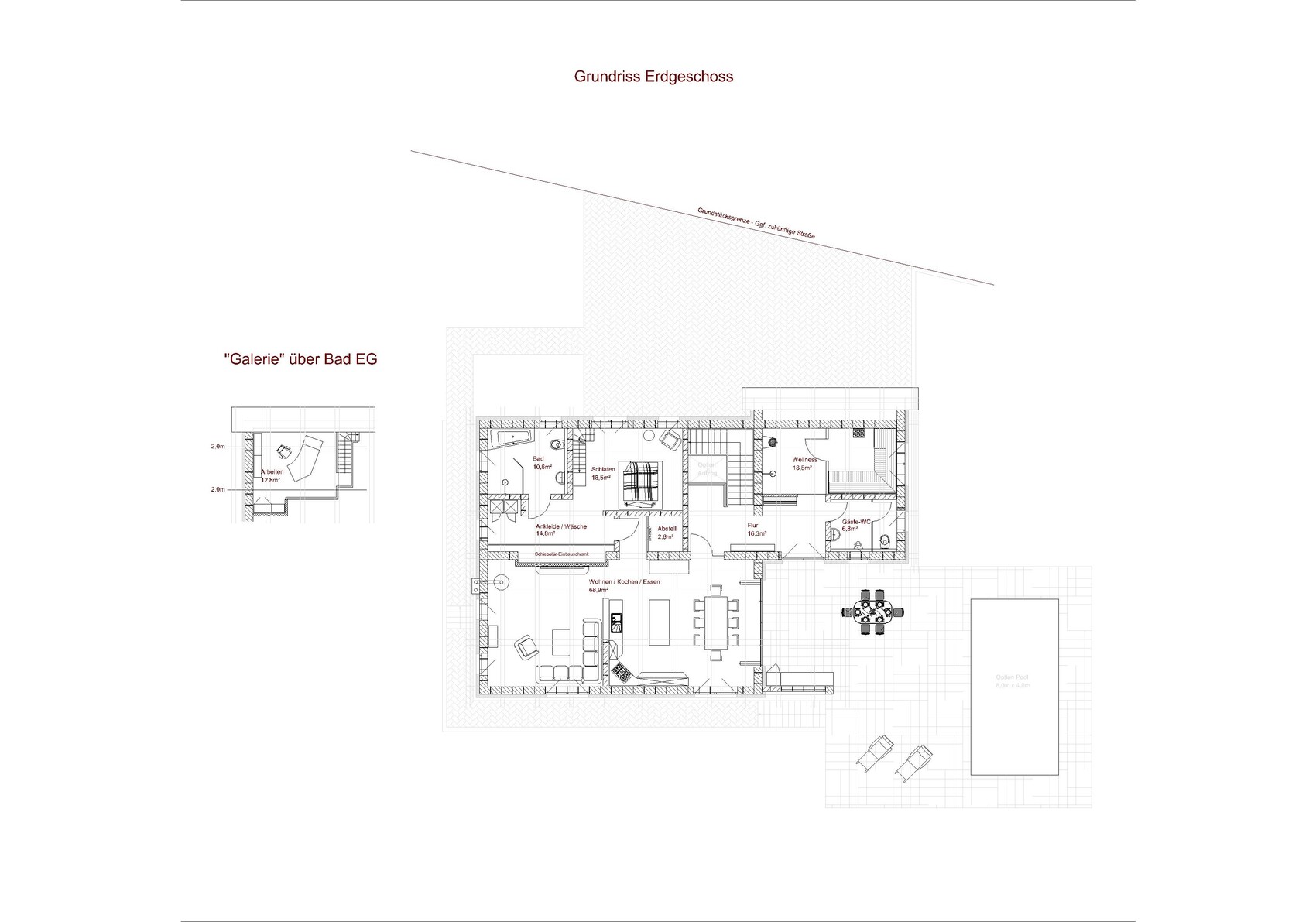

We have now decided to continue on two tracks. As recommended several times here, we will create a list of our requirements and wishes and get in touch with an architect — without providing house plans from us, only the plot.
At the same time, we’re continuing to work on our own design, gladly incorporating all the suggestions we receive here and trying to implement them.
So far, we have noted: roof shape, a more intricate entrance area, better integration of the outdoor space into the overall concept, and designing the basement so that it doesn’t count as a full floor – even though two full stories would be permitted.
We would appreciate any constructive feedback from you regarding the actual floor plans (without the roof shape): Do you see issues with drainage, are the room sizes appropriate, are the basement rooms and guest apartment functional, and so on. If anyone wants to contribute to this, many thanks in advance.

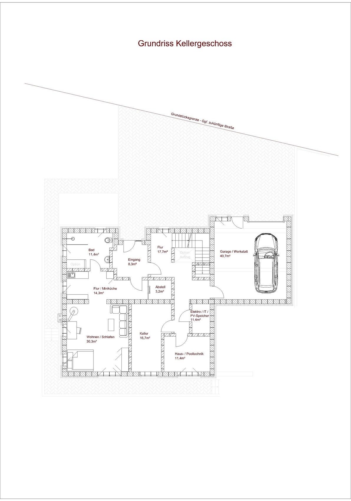

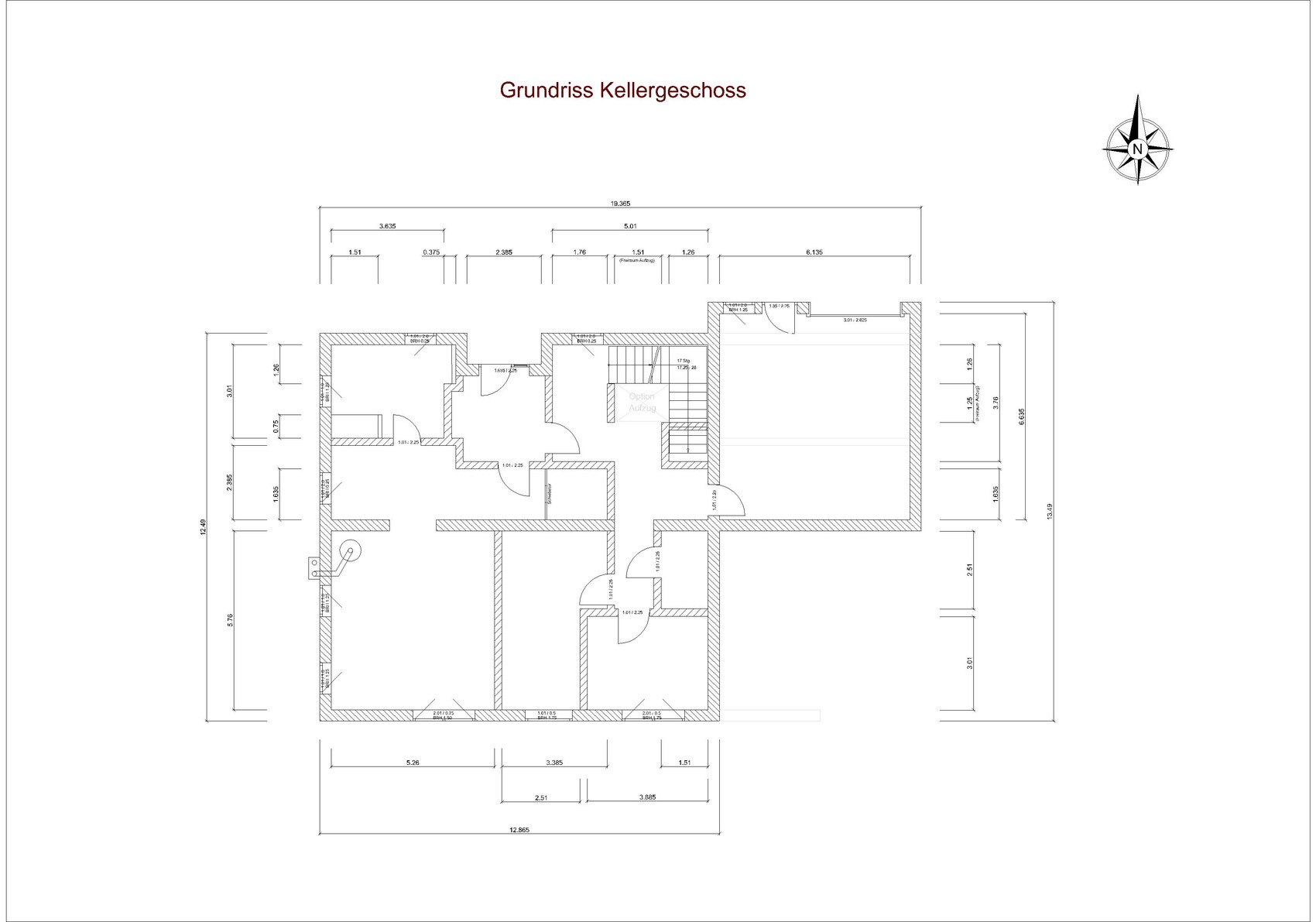

Feedback on your own floor plans, as you requested:
Ground floor:
- Bathroom of 10 m² (about 108 sq ft) seems rather small compared to the overall house size
- The passage to the shower / next to the bathtub: how many centimeters (inches) is that? It looks tight
- What is the purpose of the small staircase in the bedroom?
- What are those two “wall stubs” next to the window in the dining room?
Basement:
- Is there space for a TV by the seating area in the open room?
- Is the basement also intended for storage (kitchen supplies)? It is quite far from your kitchen
General: The layout is complex with many corners, which creates a lot of space but also means you could get lost easily – but this has already been mentioned several times.
