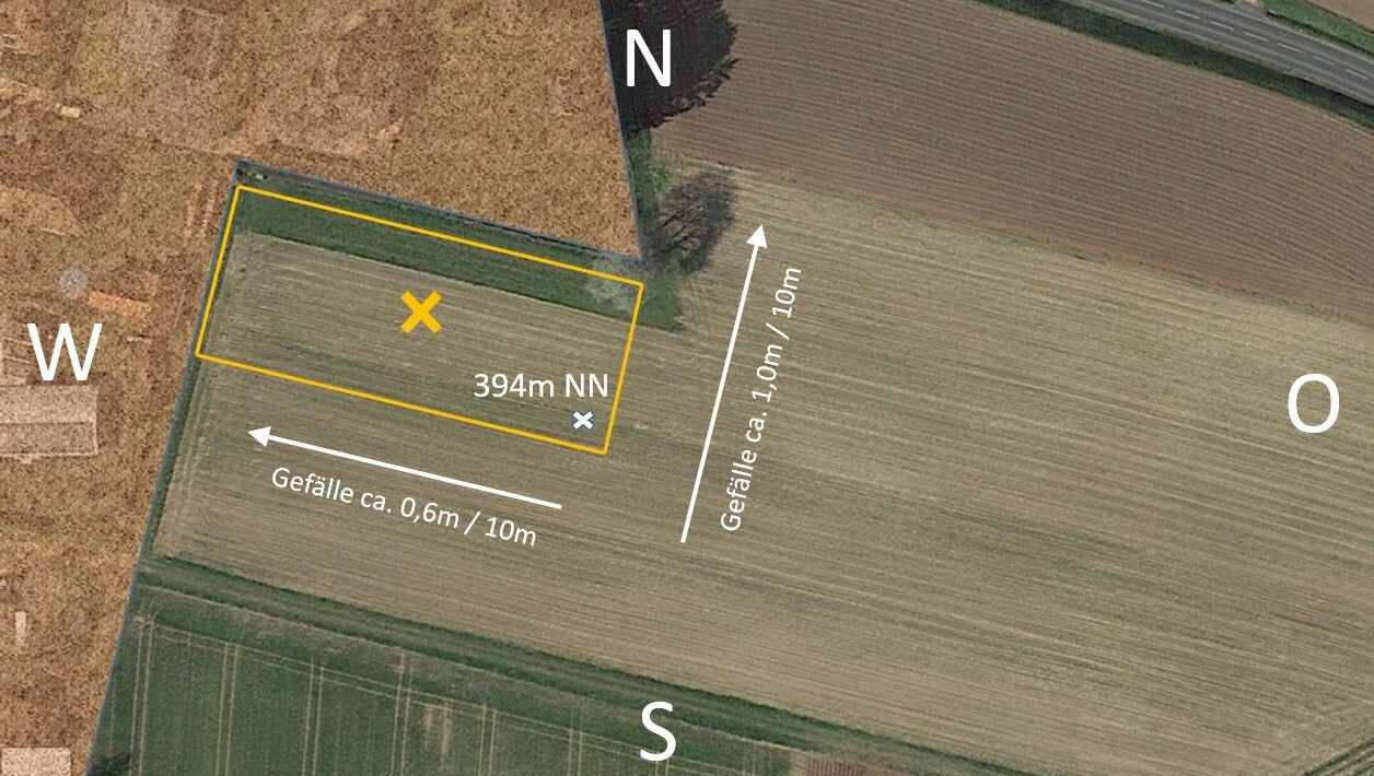

hanghaus202327 Nov 2022 13:51Is north shown at the top of the site plan?
Then, in my opinion, the slope is towards NNW.
Is there a fixed reference point with the elevation above sea level on the property?

I don’t want to post photos here at the moment; as long as the basics aren’t settled, it’s better not to stir up any trouble.
However, I did include a map image in my initial post, which at least shows the building plot.
Regarding the view:
To the east, there is a view into the distance with no buildings, only farmland and green areas.
To the south, there is a view of farmland and green areas, with forest at the horizon and no buildings.
To the west and north, there is a view of neighboring buildings and over the village.

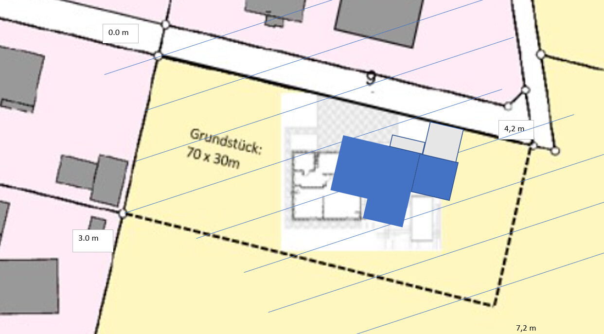

hanghaus202327 Nov 2022 14:15@hanghaus2023
Thank you for your suggestion. We had already planned the house rotation.
#47
"What we have also changed is the orientation on the plot. The house is now positioned parallel to the future street, meaning it is rotated 13° from the north/south alignment."
Attached is a visual representation of the terrain profile.
#47
