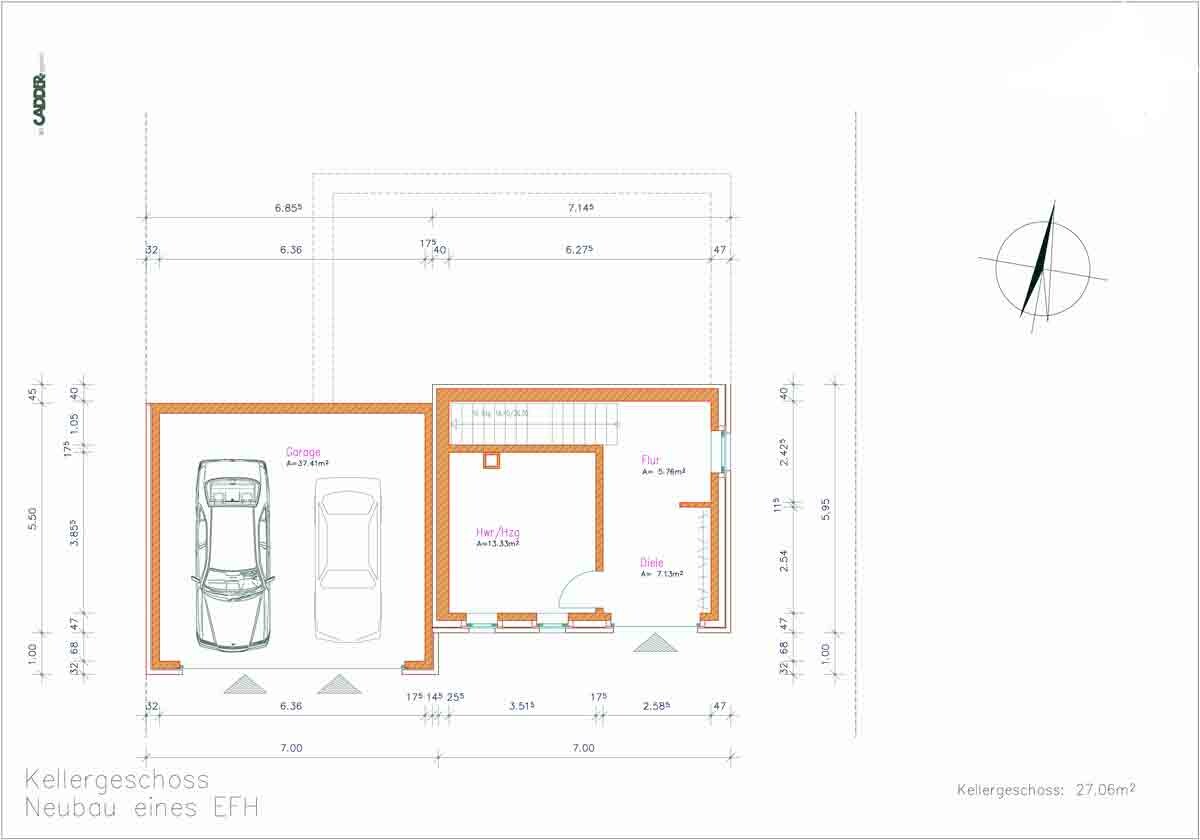

Basement
Positive:
Negative:

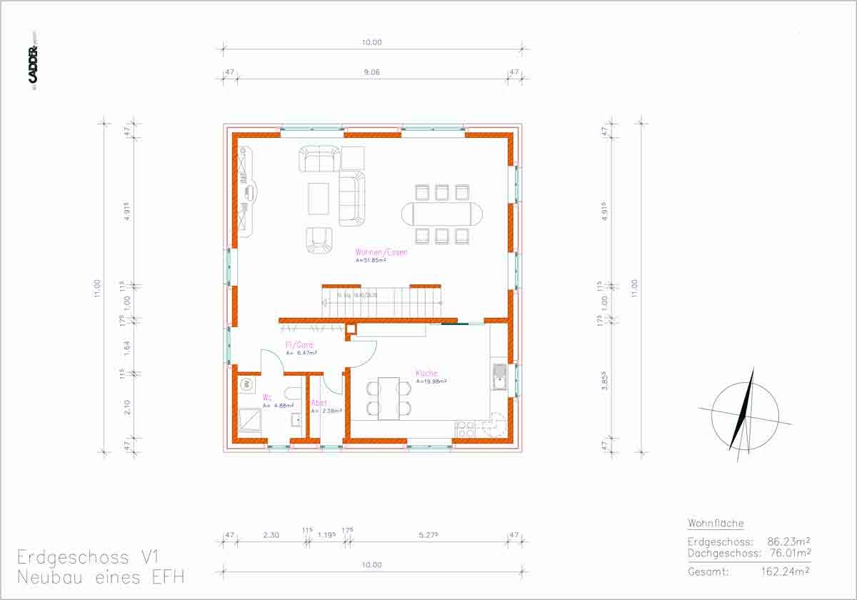

Ground Floor
We do not like this at all.

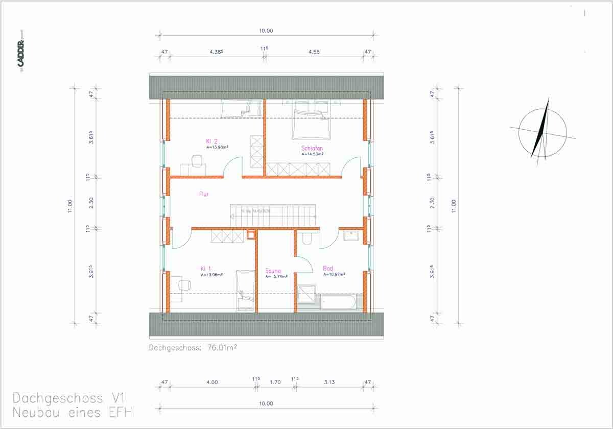

Upper Floor
Unfortunately, not 100% successful either.Hallway space is too large and wastes too much room. Therefore, the rooms are relatively small, although the total living space is over 160m² (1720 sq ft). The bathroom lacks a bidet. The bedroom should ideally not directly adjoin a child’s room, and if so, the shared wall should be the one where a large wardrobe will be placed. Do you notice anything else? We would really appreciate any criticism or suggestions. Should we actually provide improvement proposals to the architect, or just point out the issues and let them continue working?
Basement
Positive:
- Overall successful, we can quite well imagine it visually
- Nice staircase with landing, as far as we can tell.
Negative:
- The staircase might be too dark? How large is the window opposite the stairs?
- The door to the utility room should be higher to allow for a 60cm (24 inches) deep cabinet behind it.
- The two windows in the utility room would look better visually as a continuous strip of light positioned higher up.
Ground Floor
- The living room lacks a chimney for a fireplace
- A full room is missing on the ground floor. It should be an office or guest room.
- We don’t like the washing machine in the bathroom. We need space for both washer and dryer. A niche in the storage room would be sufficient.
- We would prefer the kitchen on the west side with access to the terrace on the garage roof. Maybe the front area could be mirrored entirely on the ground floor, so you can bring groceries upstairs and enter the kitchen directly to the left?
- There is no LARGE door between the living room and kitchen! We planned to be able to place the dining table in the passage when we have more guests. As it is, there is too little space in both the living room and kitchen.
- Maybe extend the ground floor a bit forward, so the entrance area is covered and there is more space upstairs.
Upper Floor

Is the top right side north or south? (Sorry for the silly question.) If north is at the top, I find the orientation of the main living areas a bit odd since they would lack natural light. Otherwise, I don’t have much time right now; I’ll get back to you later and take a closer look at the floor plans. (However, I’m a complete beginner myself and am only just before the planning stage…)
The missing office would personally bother me as well, since I’m also planning to use the office as a ground-floor bedroom in old age. For that, you would need a stairlift for the stairs in the basement, but everything on the main floor would then be accessible on one level.

The orientation is actually towards the north (top right), but we don’t see that as a problem. However, we do want to mirror the front section. That way, the kitchen would face southwest and the living room northwest. I’m not entirely sure, though, if maybe the living room and kitchen should be swapped so that the living room faces forward (south) and the kitchen is at the back (northeast or northwest).
What would you prefer?
We want several seating areas in the garden: a north-facing terrace adjacent to the house for protection from heat, a south-facing terrace in the back left of the garden for sun loungers, and a kind of southwest balcony for breakfast guests in summer. Do you think that’s okay?
